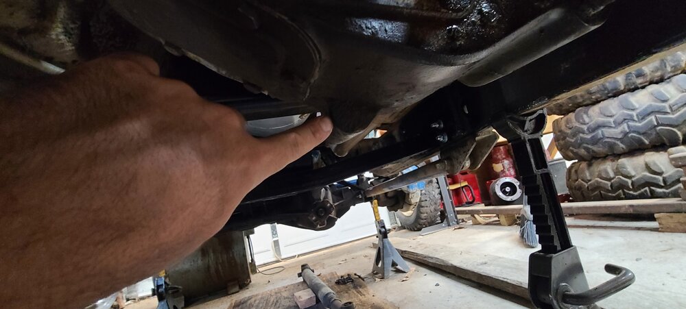

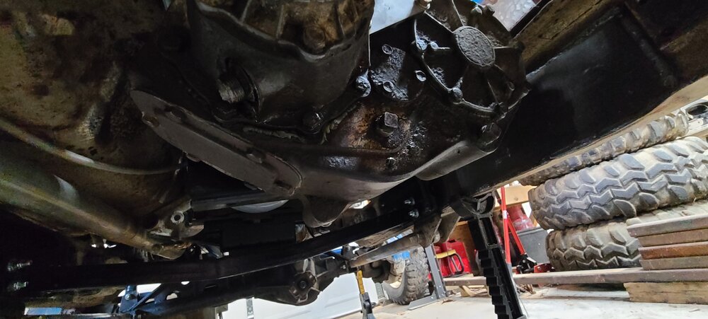

Can i cut this off?

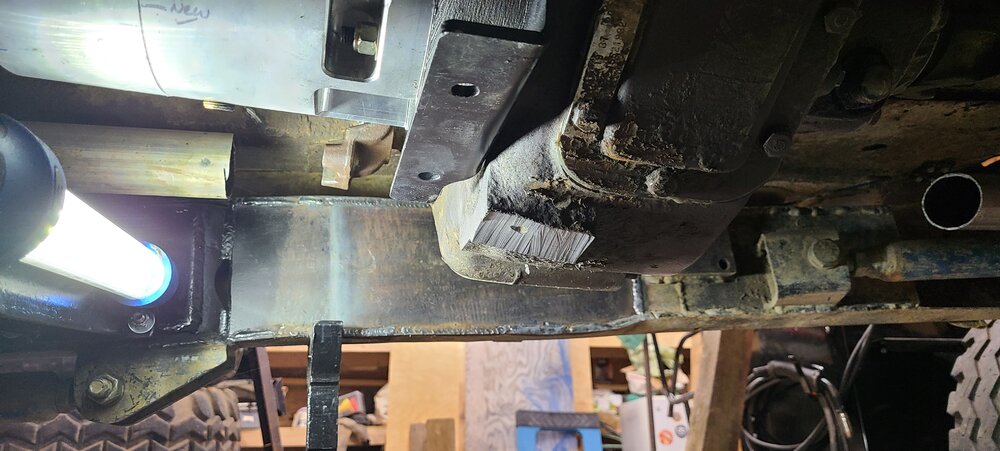

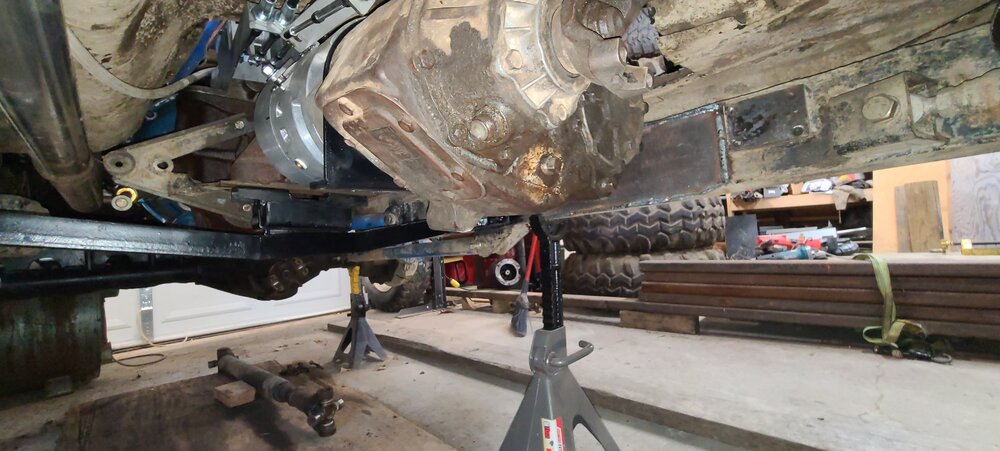

It's on a 205 that is clocked to the moon. It's in the way of my crossmember that I need to install.
What is the other side look like? Is it a bolt boss?

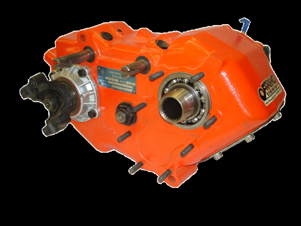

Is that a Chevy 205 I assume?
Stole this from the internet.... If that is the case it looks like at one time it had a hole there. I'd guess yes you can cut it off.
It is. I guess I can always just start and if gear oil starts pouring out I'll know :lol:
Hey if it does start to leak then you could get a Lomax gear set and case. If they still make them.....
you coudl always open the inspection cover and look down there

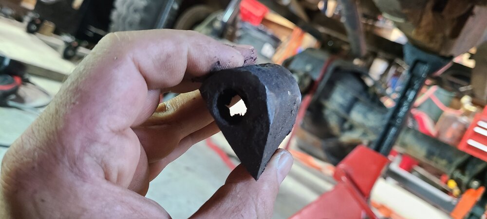

What do you know, Glenn. There was a hole in it.
Guess is what dark and I couldn't see it. Lights help. And now I've got to go wash my face off. Even with all that stuff on I got it all over me.
