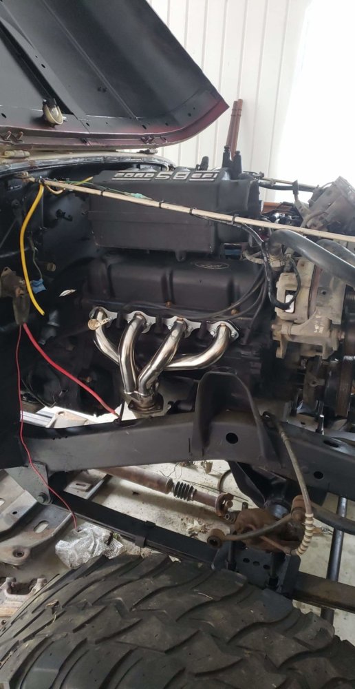

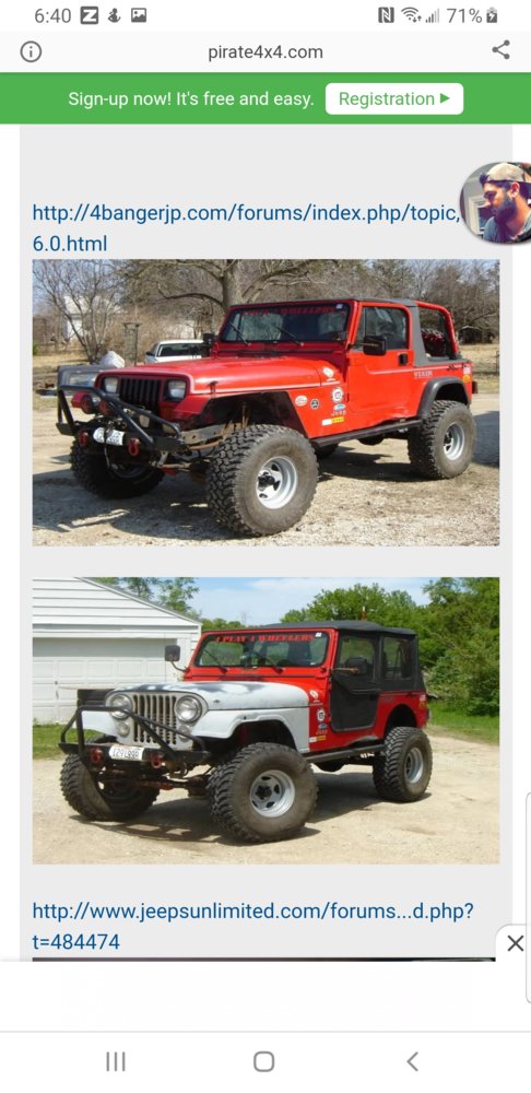

thanks I'll measure when I get back home to see the difference I'm running a ford 351 with that giant efi intake on it it hits up front on the throttlebody where the hood slopes down to the grill not much maybe an inch or two I'm not sure if I have a pic of it not clearing I'll look and see I found a comparison pic online and it looks like the front of the cj hood is taller the front is where I need the hood to be taller the rear clears fine
you can kinda see the issue here it clears without the throttle body it's just the very front that's the issue any ford guys out there know what all is involved in the gt40 intake swap? heres a pic with the hood down it's not far from closing

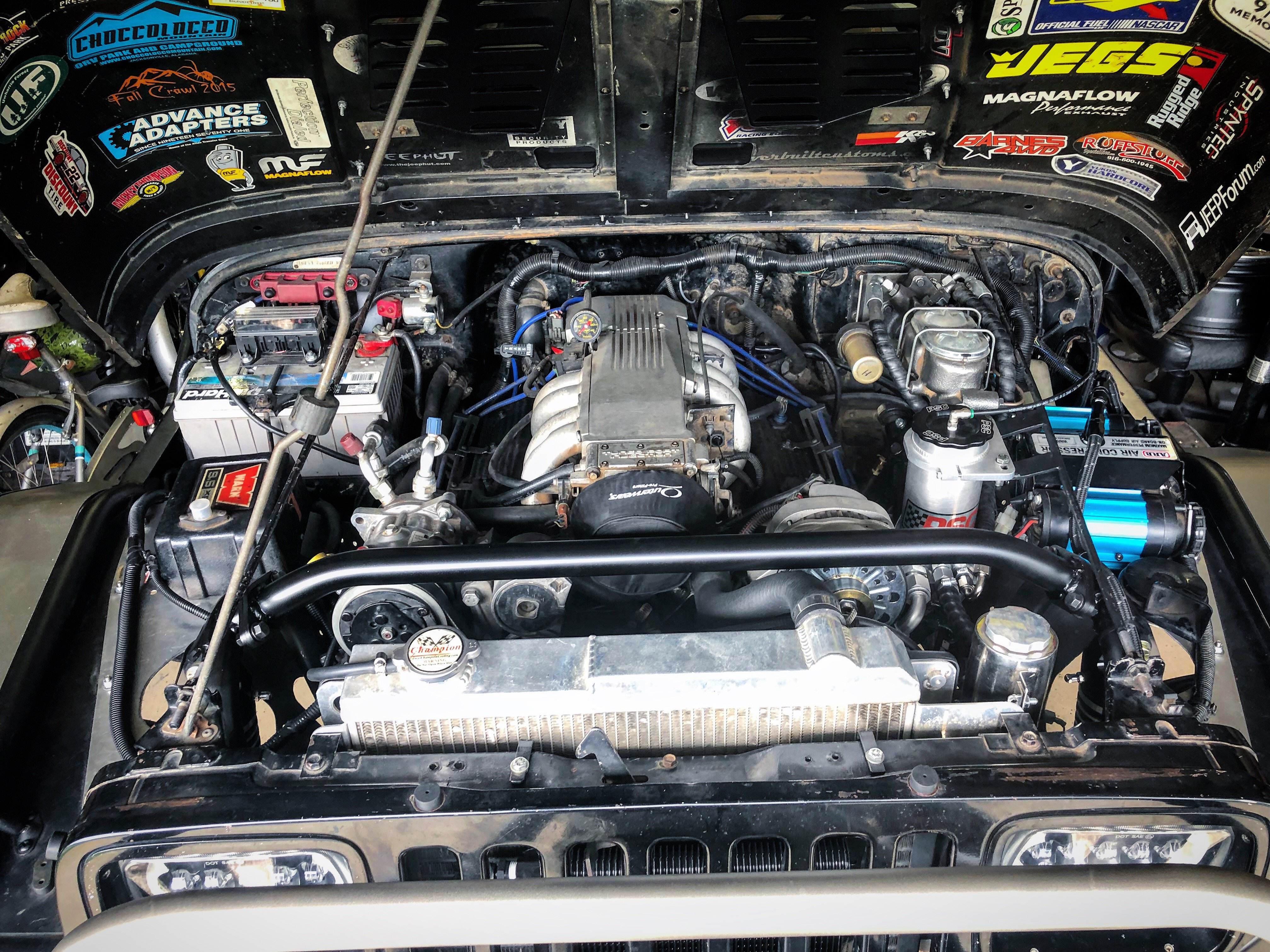

Ford 5.8L 351w EFI 1986-93 Qualifier Upper and Lower Intake Manifold Kit Satin you need one of these. This is what I had bought to fit a 5.8 in a bronco. In the end though I got a regular dual plane carbureted intake and Holley sniper EFI to get rid of the Ford speed density.
ok I'm probably gonna keep the oem fuel injection for now I like this intake and it's not as crazy expensive as some of the other options I've looked at did you have to run a different throttle body?
It uses a 5.0 style 70mm throttle body. This is pretty much a gt40 swap just cheaper and better.
thanks for this info I was wondering how I was gonna chop the hood and make a new intake that split into two parts to go through the throttle body this looks like its gonna solve a lot of my issues

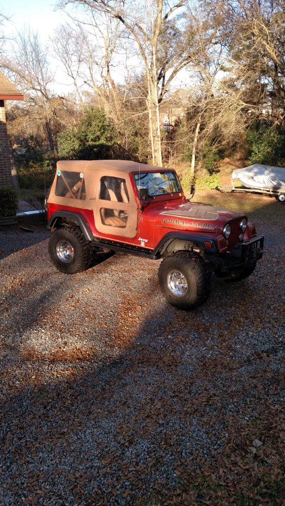

Sounds like the manifold swap is the ticket. Looks like the CJ grill & hood, are taller. You said you didn't want a body lift. One of the first things I ever did on mine, to run 33s, was a 2" lift. When I replaced the springs, they have a 2 & 1/2 " lift, & stock height shackles. Only thing I did with the body lift, was extend the clutch linkage. When I added a fan shroud, I had to re-center/drop the radiator. Hard to tell there's any lift, & I clear 35s now. But, it's getting harder to lift my leg high enough to get in & out, now.:lol:
