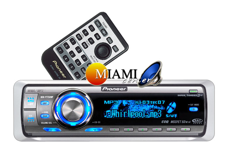

Pioneer 7750
I looked for an owners manual to see if I could walk you through it. The fact of the matter is, you need to check the manual and see if it has some sort of "Speed Controlled Volume". That's a nice deck. Pioneer has some of the best internal amps on the market today. The built-in crossovers help immensely, too. If you need a hand setting the EQs and levels, gimme a call sometime and swing by. We'll have a party! I do recommend an amp, Infinitys are pretty hungry speakers. However, I'd hold off until you're sure the stereo is doing all it can do.
