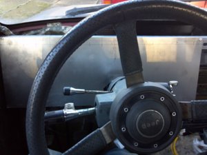

I did no carpet , Have 12g sheet metal dash still being built. Carpet is nice if you dont 4 wheel with it. Iv been there and had that and ended up ripping it out after if was wet .
see
