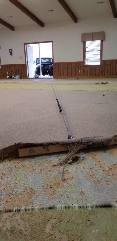

We often have to remove old carpet before installing new carpet. Most of the time, the previous installer, uses cheap glue and a small notched trowel, which makes it rather easy to remove the old carpet, especially if we cut it into narrower strips.....BUT, Sometimes we come across carpet that just wont come up. No matter how hard we pull, it's not budging. ITS THE GLUE! It is on too thick and it is the best glue money can buy... practically perminent ..it is stuck!

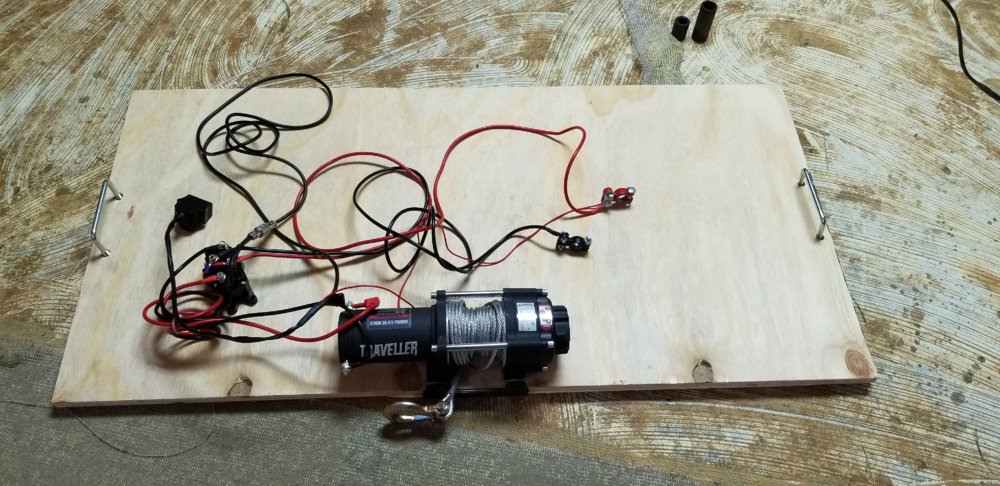

So... I decided to build myself a carpet winch!

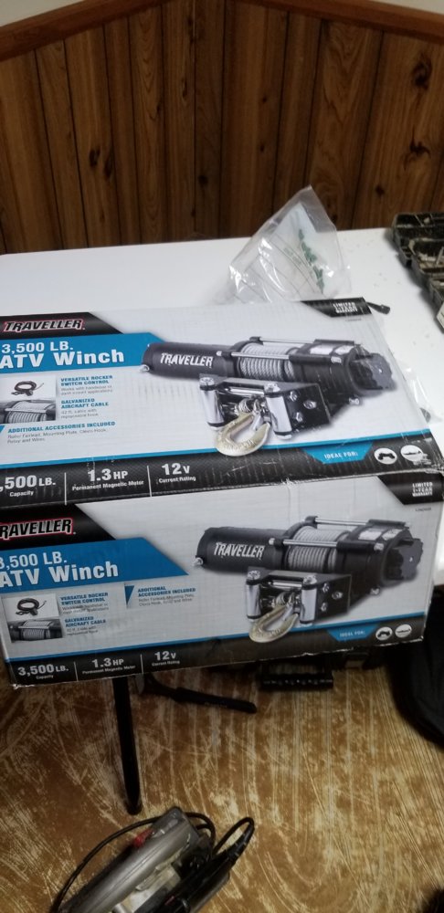

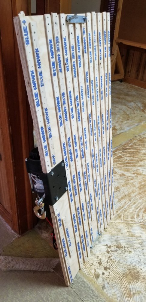

3500 lb ATV winch attached to 3/4 plywood. Couple of handles, and a bunch of tackstrip nailed to the bottom , makes a good anchor.

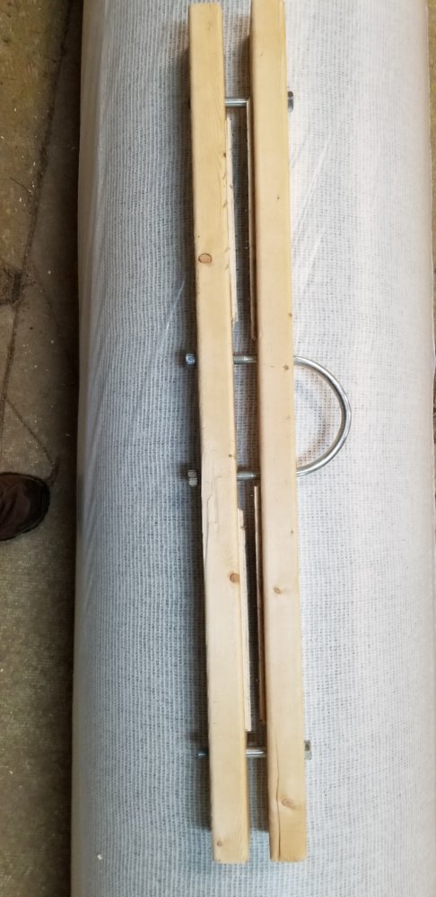

We've used a scissor lift with 2x's attached by cable then you can drive it. AS long as you need a lift on the job for demo. I've also seen a contractor had some type of tool that had a handle a wheel and a blade so you could cut it into strips before pulling it.
