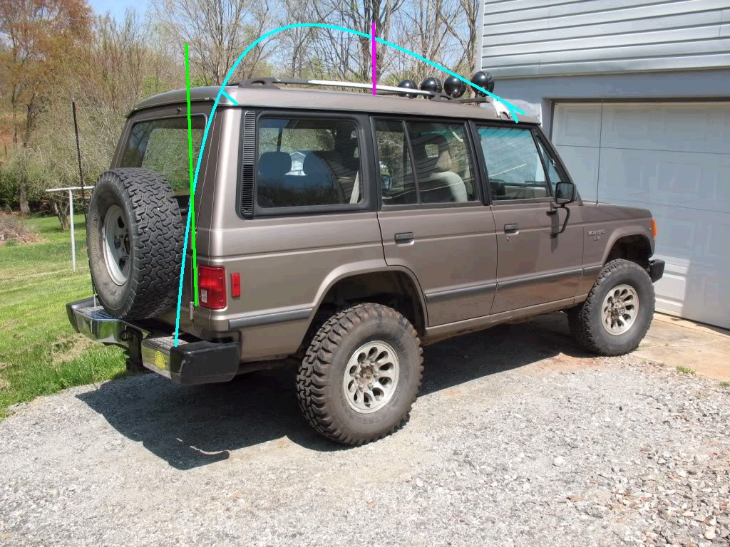

Thanks for the input. I have been doing some more reading and have a better understanding. I have come up with 3 different options I am concidering.
1. A short 2' antenna with a strong magnet base mounted to the roof of the montero.
2. A 5' fire stick set up higher up on the back bumper so that the antenna is more over the roof.
3. A 102" whip from the rear bumper with 2 anchors. one at the end to the roof making a bow and a second towards the end so that it does not sway to much and if it pops the front tie down it will not whip all the way back.
The picture shows my old fire stick and how it barely was above the roof line. Also my three options. Option 1 in purple, option 2 in green, option 3 in cyan.
with the options you have above, the 2' on a magnet base would probably be your best/easiest option.
