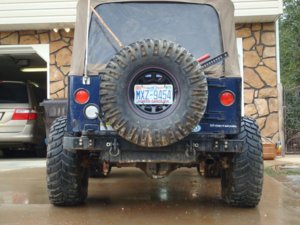

Here is how I mounted the antenna
You can pick up the cable, mount and I would get a spring for the mount since its going to rock back and forth allot, at your local truck stop, most carry a good bit of cb stock.
