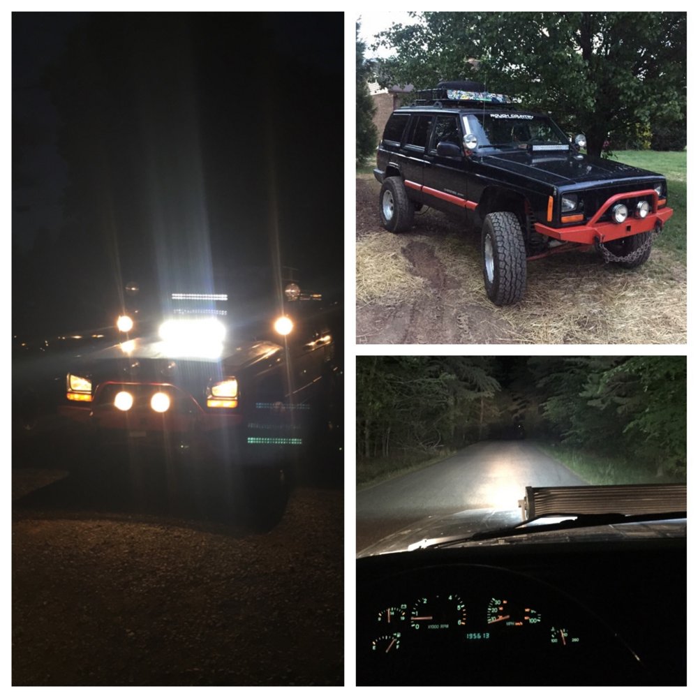

My child haha

Since I have a roof rack does it need to be higher than the rack or just the roof line?
