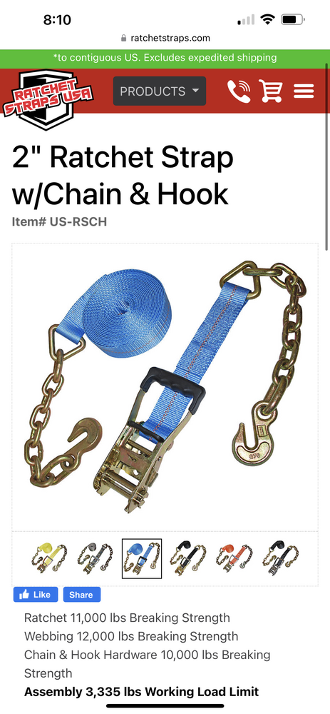

@Curtis_H talked me into a set of these. And they are the ticket. I know full chains have their places. But this setup allows you to have enough chain to prevent straps running. Plenty of chain to loop around axles or stake pockets
