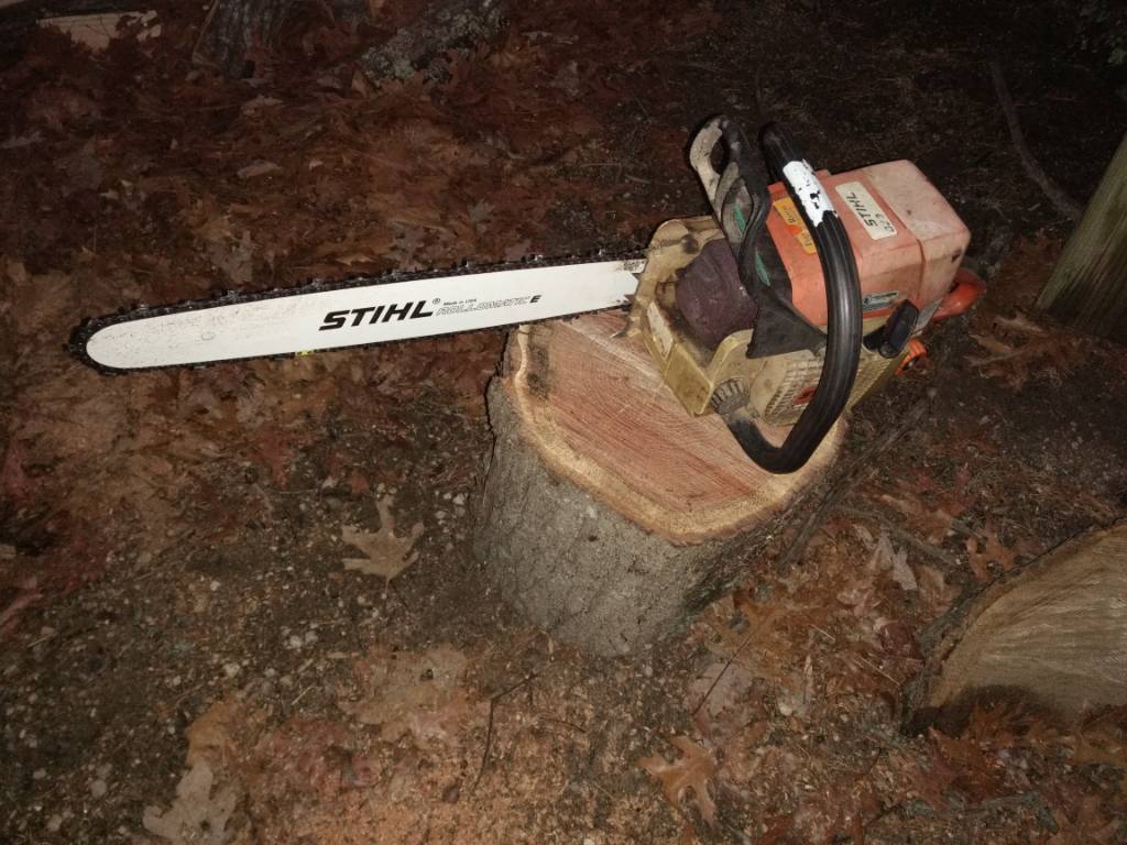

I bought a new stihl chain last year. It still cuts crooked. You can see the wear on the bar where it has worn down. The chain is really sloppy left to right in the bar slot. And they both are .062. I always take my chains to the hardware store to sharpen them. He's gonna do a better job than me for $5. I actually think I may hit the Ace today and get a new Stihl bar and chain. Screw it.

New Stihl bar and chain. Cut like a champ. Nice and straight I do think it's more the bar. I bought one of the same chain last year, and it still cut crooked.

And the saw looks like shit because I got it from my mother in law. Her husband leaves everything sitting outside. Still hard to beat for free. Pulled the carb and cleaned it, then it runs great.
