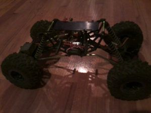

this is a pic of the axial I got with no body on it. Thanks Rich!
That looks to be an AX10. The 1200-1500 mah would be a good size for that but will cut down on runtime. The 2000mah will work fine but will put more weight higher up on the chassis which will cause it to roll over easier. Have to find that balance between battery capacity for more runtime vs. battery size for better performance/less weight.
