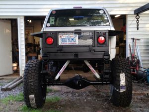

F250 cheapie yellow Monroe’s with the shields cutoff, krylon’d white and eBay procomp stickers. Still on the truck and this was a good five years ago. The shafts have started to rust near the top but no leaks yet. I’ll leave them until they do crap out.
