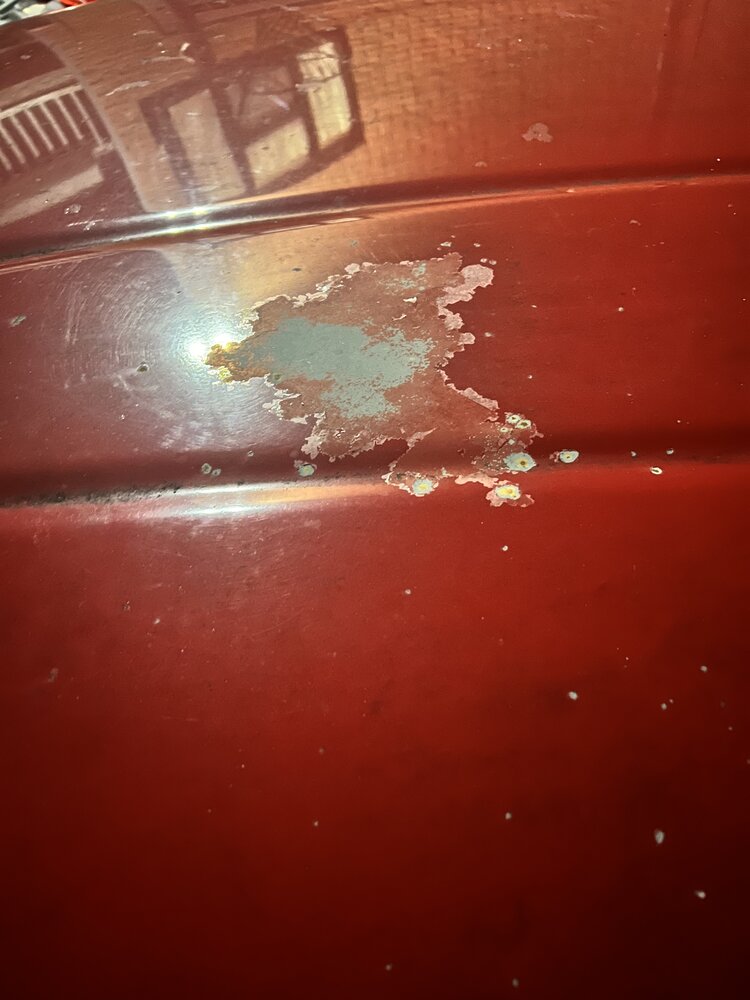

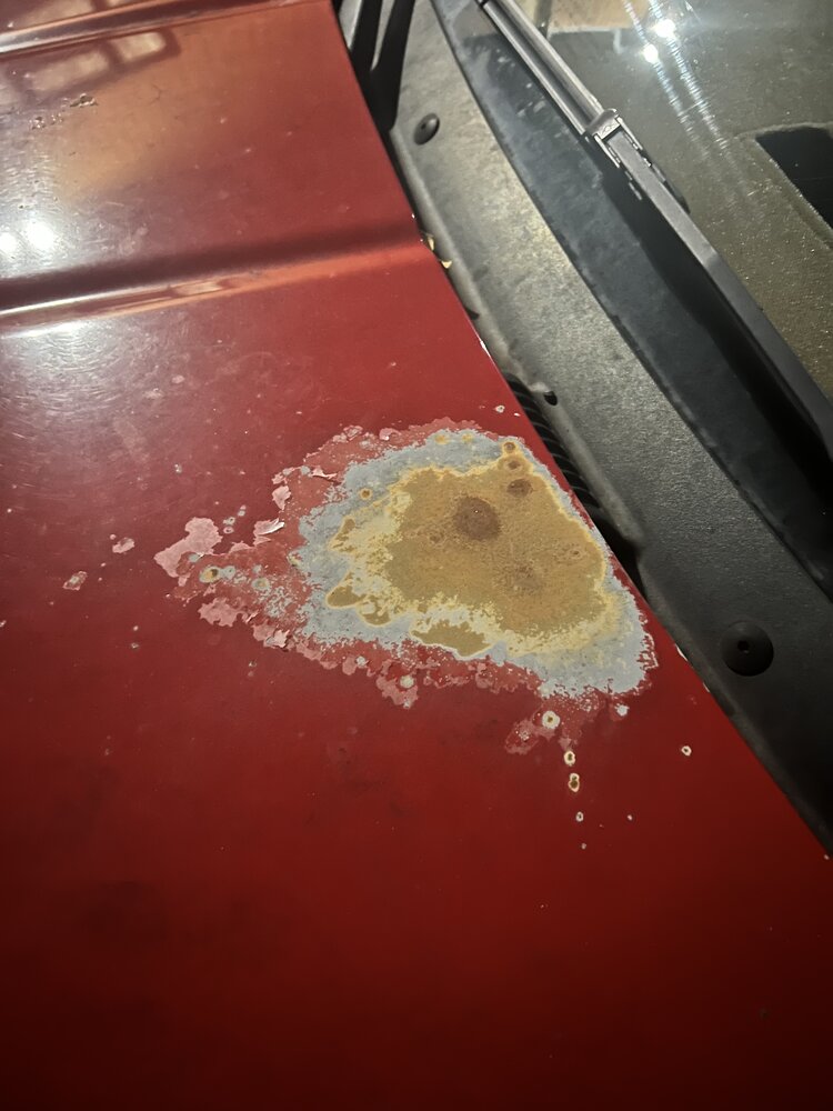

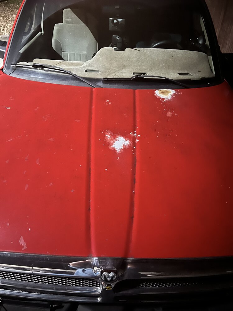

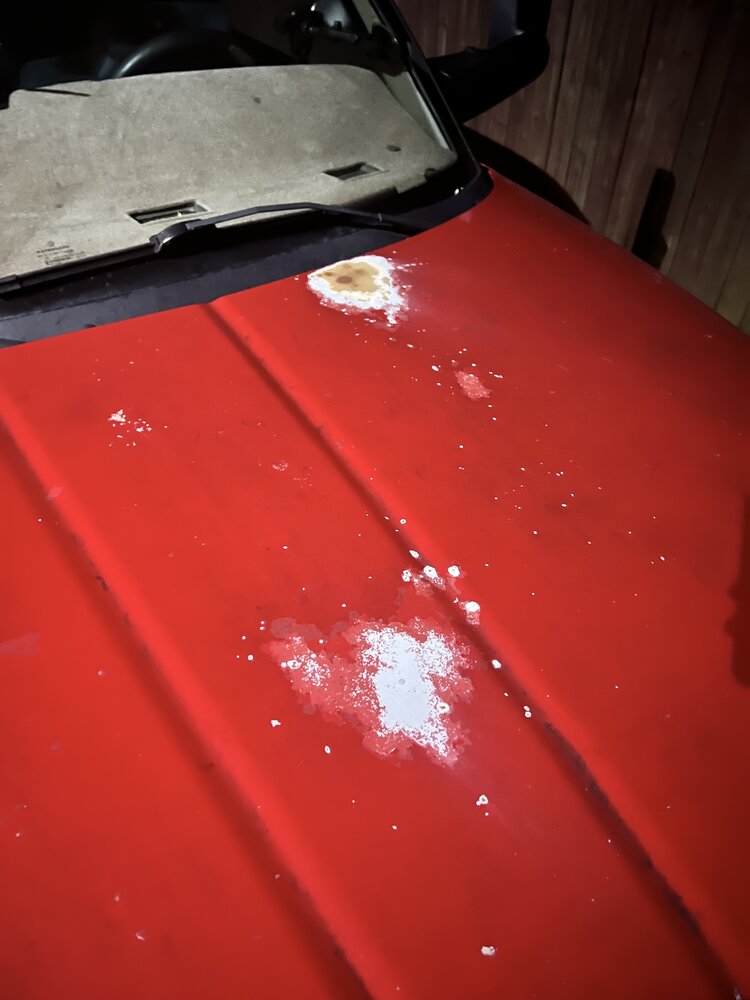

It is the hood on my 96 dodge. Has the typical 2nd gen sun burn on it and starting to get light surface rust in one spot.

thanks guys. Here are some pics of it helps.

Get a corded DA, sand it down, get some matching Duplicolor rattle cans and spray it your self. They even have clear coat in the can too. That’s a no brainer. Other wise if it’s straight (no repair needed) drop it off at macco and let them shoot it. If it’s a “good” macco they will color match to your factory faded red so it doesn’t stick out like a sore thumb.
