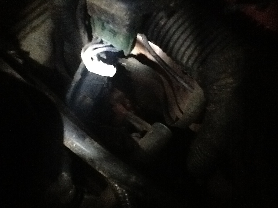

Is this what your talking about negative ground? (Silver, skinny snake thing lol)

any luck on the jeep yet, and yes that was the ground I was mentioning. sorry the cps didn't work for you but as I stated for the cheap price it's a great part to have new anyways. spray some ether or GAS in the TB and be done with it!!! it runs, fuel problem, it don't run spark problem and we can go from there. (easier than doing electrical testing)
Is this what your talking about negative ground? (Silver, skinny snake thing lol)View attachment 71033
is it just me or is that cable frayed in half, if so theres your issue. only the older Cherokees have that issues where that ground strap is for the ignition system and such. don't quote me on your year model being that one but I know the renix and early 90s are.
