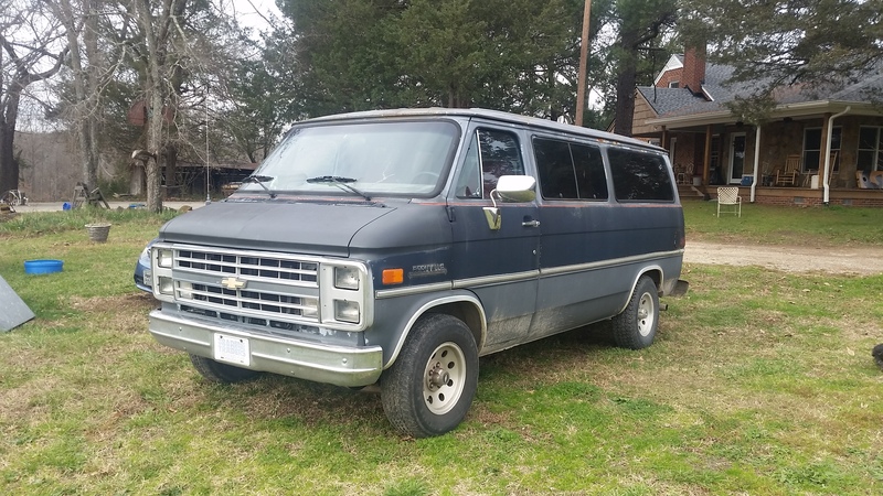

My dad has a 91 chevy G20 van with a 350 motor and 4L60 trans. Four years ago the trans was serviced and the torque converter replaced. The truck has 131k miles and leaks 1 quart of oil every 3k miles.
I am interested in taking this van from Greensboro, NC to Brawley, CA towing a trailer loaded with quads to ride at the Glamis sand dunes in Feb of 2017. I have some concerns about the van that I hope someone can help me with.
First, is that motor and trans strong and reliable enough to make this kind of trip towing a trailer? I have two choices for trailers. One is a 16ft open which will weigh about 3500 lbs loaded. The other is a 24ft enclosed featherlite which I think will be at 7000 lbs loaded. Is the enclosed trailer even an option?

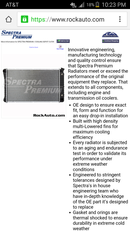

Brand new aluminum radiator from RockAuto is $100. Seems like a no-brainer to me.
It's an aluminum radiator with plastic tanks. There's nothing inherently wrong with plastic tanks. A new, plastic tank, aluminum core radiator is superior in every way to a 25 year old leaking radiator, regardless of its original construction.

So a cheap, new $100 radiator should cool just as well and hold just as much coolant as the OEM?
OK, I'll buy a new radiator and add an auxillary trans cooler and temp sensor.

I would search all the parts stores for a good quality HD (3 row?) radiator.
Oddly enough, all the radiators I found were single row. The only difference was in the core thickness (1" for standard duty, 1.25 or 1.5" for HD). Being that it's a van, I suspect this is reflective of a packaging issue.
I thought it was a typo at first, but they all said the same thing.
