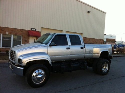

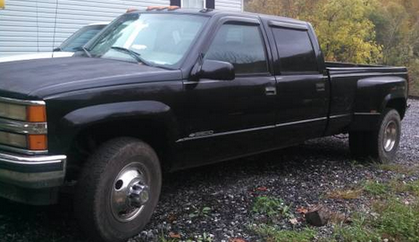

Ok, so this is in the planning stage. I would love to convert my 2000 K3500 Chevy Crew Cab Dually
into one of these monsters

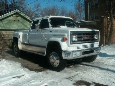

There ar alot of conversions out there that people do taking a Kodiak or Top Kick and putting the dually bed on. I want to take my 3500 and add the front clip. So far here is what I'm thinking:
1. Chevy Kodiak front clip
2. Rockwells front and rear
3. 454 swap to 6bt
Any ideas and thoughts?

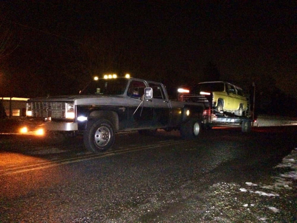

Ive seriously considered turning this
into this so i can double my legal gvwr
I thought about throwing a set of f550 axles super 60 front with 4.88s and a eaton 2speed rear. 8.3 cummins heart and a rtoo9513 trans with a 5ton t case
