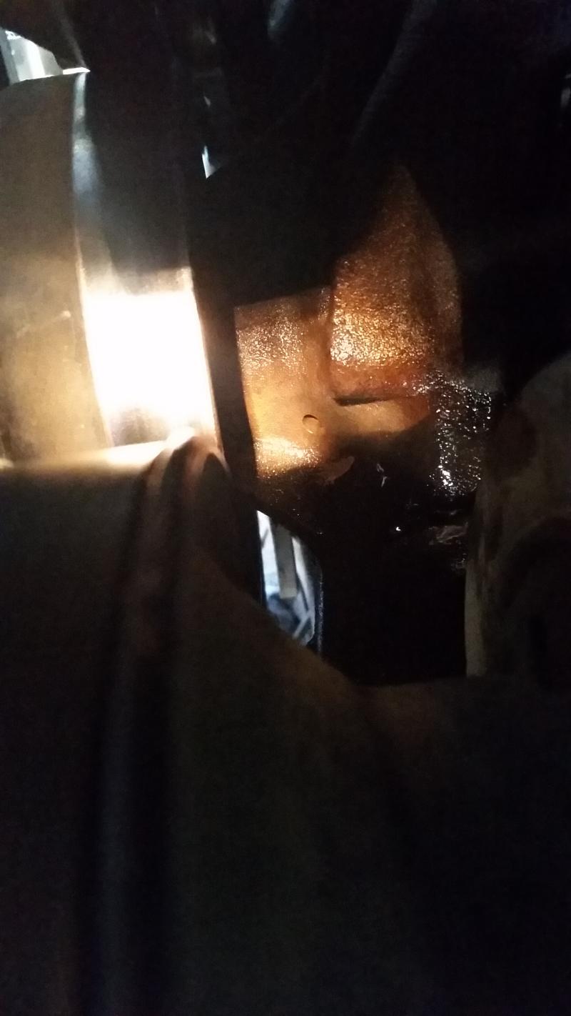

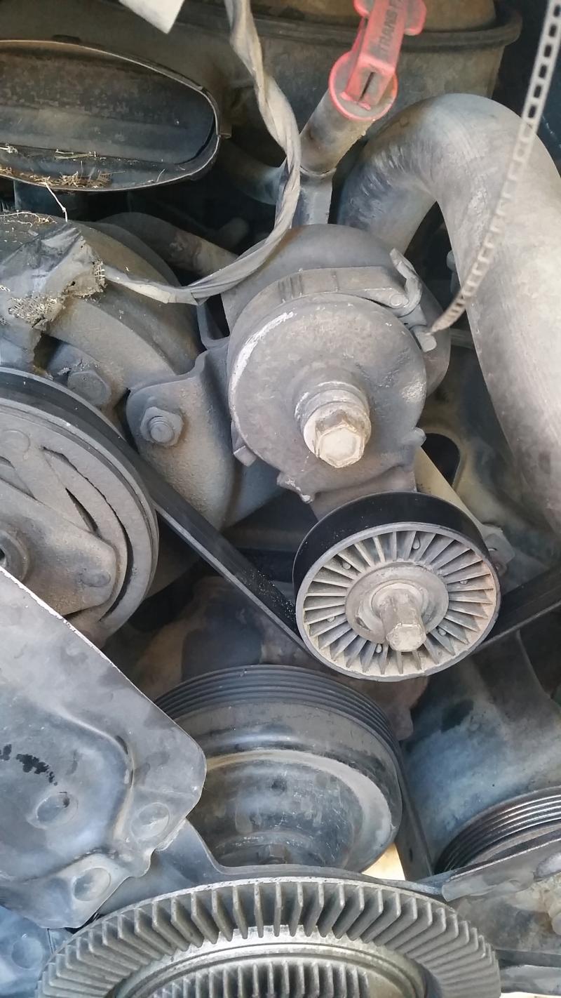

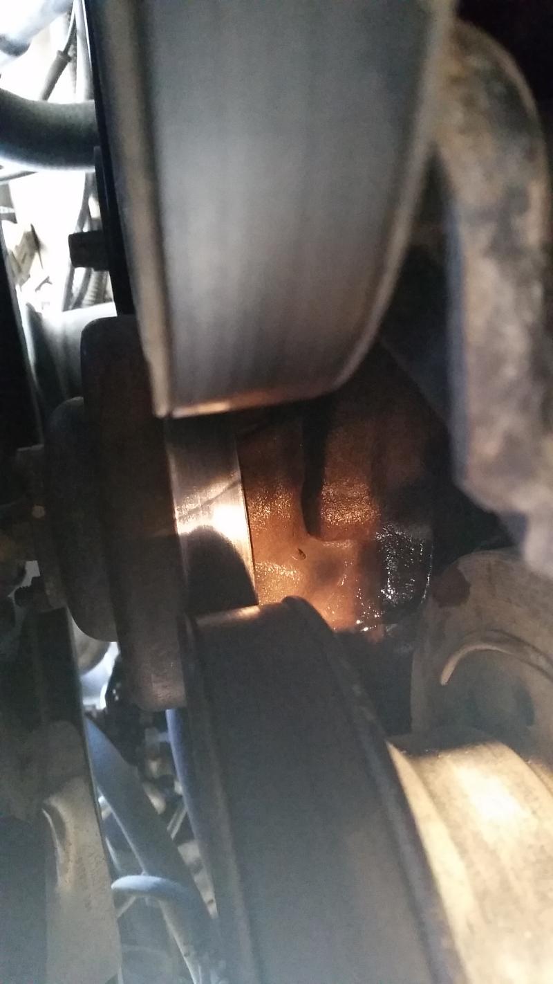

My dad has this 91 Chevy 3/4 ton van. It's started dumping coolant and when I crawled under it I saw the coolant leaking from this home in the bottom of the pump? What is that hoke for and why is it leaking coolant?

It's the weep hole. The packing that keeps coolant out of the bearing is bad. It means it's time to replace the pump. No big deal.

Shouldn't have to remove the tensioner. Will it not release if you put a socket on it and twist counter clockwise?
