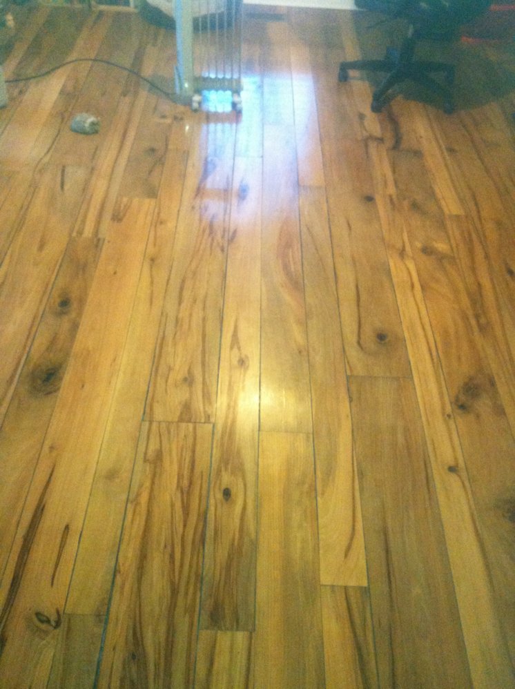

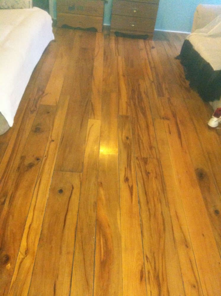

Sweet Gum hardwood flooring I installed in my living room...
Had to do something with all the SG's I had to cut down around my house. I hauled the logs to a sawmill and had cut to 3/4, planed and T&G'd. He lied and charged me for more than I got out of it. Supposed to have had enough to do my back bedroom but was shorted about 75-80 bf after all cleaned up. Had to purchase a radial arm saw to do the job and have yet to find another purpose besides a corner filler in my shed for it. This was 4 years ago...
SG is pretty hard but I give it a 7 out of 10 at most. It still dents exactly like the heart pine in the bedroom. My floor sees much heavier traffic than most being we have 8 (going on 9) grand children and a chest of toys in the living room. Plus my office chair at my computer desk becomes entertainment at times. I think it just adds character...
I don't know of any other SG flooring in NC??? I did a google search trying to figure out what to do with my logs and found where a Hardwood Flooring Association took a challenge to floor with it and was totally surprised. What I learned was that it has to go down on a solid subfloor (not OSB or anything). You can not use a felt paper for the flooring has to be wood glued down to the subfloor. Also it swales and contracts quite a lot especially for the 12" wide boards. And being we put it down in the Early Spring, it bows some in the winter time.
Also, it's the bendiest wood ever... Was the hardest hardwood flooring 10 times fold to ever lay. Took me and 2 other strong boys every muscle with screwing leverage boards down and pulling it into place with about every nail. Also had to nail it like every 8-10 inches. It is extremely twisty wood so there are some wider gaps that were filled. Was the best we could do...
My house is 100 years old and reminds me of a circus house with trick mirrors. There's nothing square about it. I've gone with the cobbled look throughout and I think the LR floor was a very nice add.
