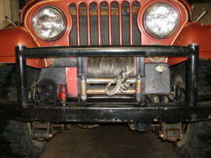

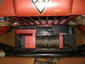

For my [old] Husky Superwinch, I used what I had. Bumper was already there, but had to extend it out 1 1/2". Welded 1/4 angle, to the inside of bumper, flush with top. Laid a flat 1/8 plate, between the bumper[over angle], & on top of frame crossmember. 2 bolts threw the rear of plate, & crossmember.
Then the winch bolts=2 threw the angle & plate/ 2 threw crossmember & plate. The plate, just mainly covers the open space. Welded to uprights in bumper, for the fairlead. Been there for 21 yrs.+!
DANG! No wonder it's worn out.:lol:
