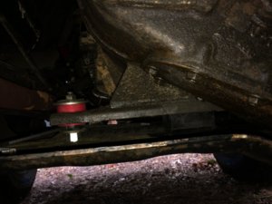

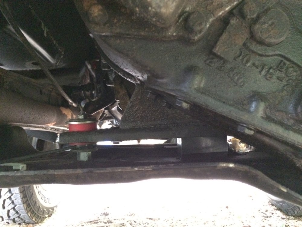

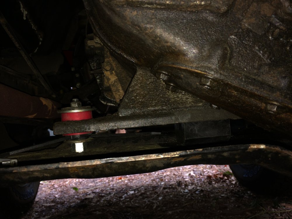

Running into a bit of bad luck lately which is forcing me to do my AX15 swap before I had planned, and rather promptly as I'm trying to beat the ticking time bomb that my T5 has turned in to.
I think I've got most of it figured out but would like some input from y'all on what to do about my trans cross member/skid plate. The new drivetrain will be ~2.25" longer, so my mounts need to change.
Part of the AX15 swap involves an adapter for the D300 which allows me to clock the t-case, so that will be nearly flat (I'm not running a body lift).
Another aspect I want to keep is the stock style trans mount w/ torque arm.
My first thought is to run a Barnes 3" drop skid w/ the optional braces welded in and measured/drilled for the trans mounts.
Or, have a stand alone cross member made and then run a skid under that?
If it was your vehicle that you drove daily, and had to maintain, what would you do?
^This^... just ask the folks that have to drop links or hang the drivetrain from the cage, to unbolt the skid... to change fluids or a u-joint. Phuckdat!
I'll be ditching the OE crossmember (stamped POS "catch-ALL") for another inch or 2 under the TC and the ability to run a skid (Barnes is #1 on the possibilities list)
Cool. That's kind of what I was thinking.
