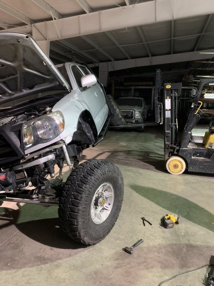

When at full droop, the pinion on the axle will rotate down making your U joint possibly bind
Axle moves forward when drooped so you need a front driveshaft with a longer splined section.
If you zoom in you can see what I’m saying on my old Tacoma.

Not having to run a long travel drive shaft or have your axle trying to drive out from under your truck is a nice case for shackles forward! I like, @Van-go , went shackles forward on my tacoma for mostly the same reasons. Also you can keep it lower (trying to remember back to my yj days if that was even a factor).
