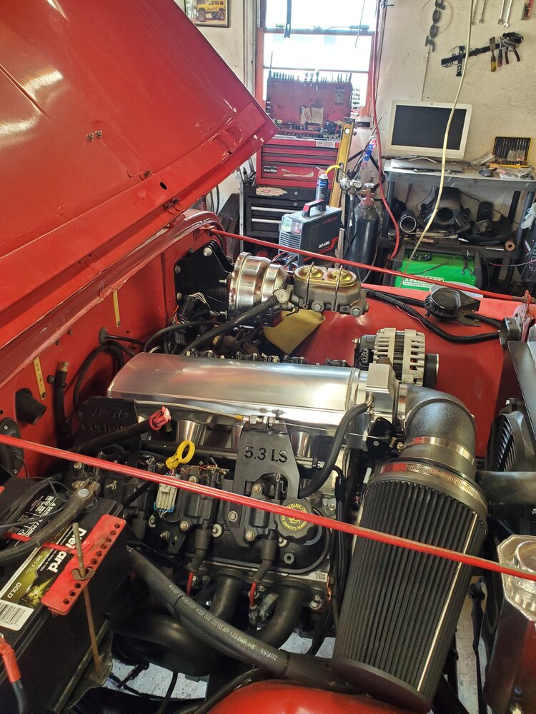

Has any of you used one of these brake booster upgrades on a CJ7 and did it help/make a good difference?
I just finished this LS swap in this CJ and brakes totally suck...like hardly no power brakes and customer says 2yrs ago when he put the booster on he never really noticed a difference then and of course not noticing a difference now either. It sad for last 2yrs at another shop till he brought it to me couple months ago to do the swap and now I'm done but dang brakes are terrible.
Did he just happen to get a booster "bad out of the box"?? thanks for any advise
he's ok with buying another one if you guys believe he just got a dud or anyone else use any worthy upgrade to help stop all this power he's got now.

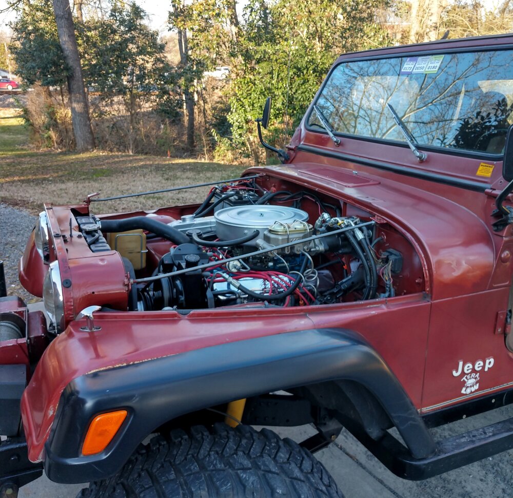

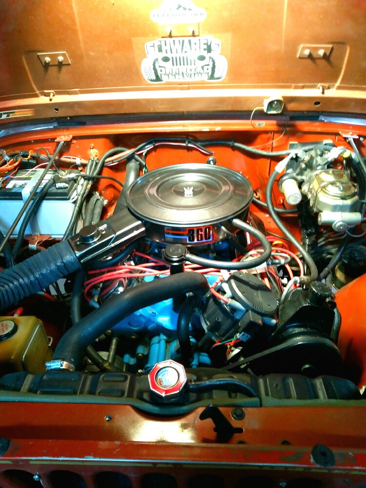

I went so many years with No booster & piss poor brakes, when I upgraded, I went Hydro-vac! If your not used to it, your face will hit the windshield! Stock brakes, disc/drum & 35" rubber.

your plunger depth is probably off. the booster to master plunger requires a specific depth. those kits usually come with spacers
edit: and youre also positive you have no air in the lines? did you do a vac bleed, or old school pumping the brakes while a second open and closes the bleeder?
edit2: wheres your distribution block? is on the fender like oe?

The booster and master come complete as a set, so one would assume that the plunger would be correct?
correct, summit racing sells em as a complete unit so we'll see if new one is legit lol
this looks like a mbm kit. mine did not come pre assembled. mine had various plunger spacers i could add (steel solid cylinders like the size of a pencil). I had to ensure the pedal side had proper travel, and the booster to master had proper travel by taking measurements. They also came in handy when i upgraded the master to the ford e350 one.
