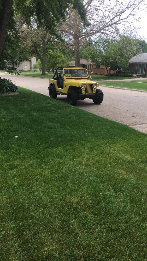

just bought this lil girl. It's my first ever build, so I'm looking for advice and pictures for a spring over Axel and Axel stretch in front and rear. I've found stuff on the SOA but not so much about the Axel stretch. It's going to be a long process, anyone got pictures of their cj7s or links to threads?

I've done yota springs on the rears of a couple, that plus offset spring perches is good for maybe 5-7" stretch depending on the year model springs you go with. Current heep has waggy fronts also for another couple inches.
