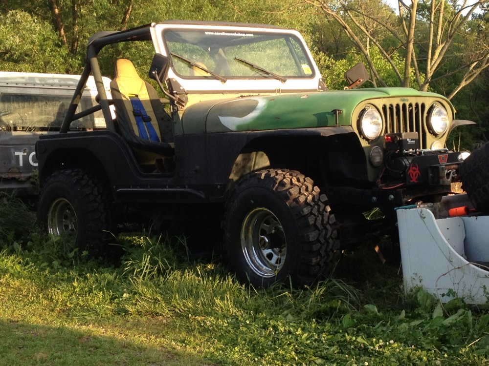

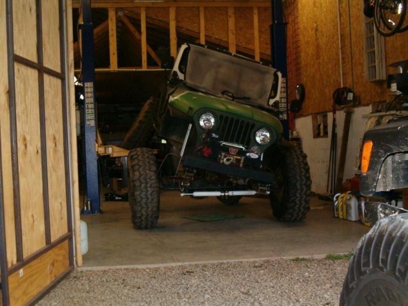

I ran 38's on a CJ5 using the factory rear springs up front in SOA with a BDS add-a-leaf. Flexed great.
Pic when it had 35's.
Only good pic I have with 38's
