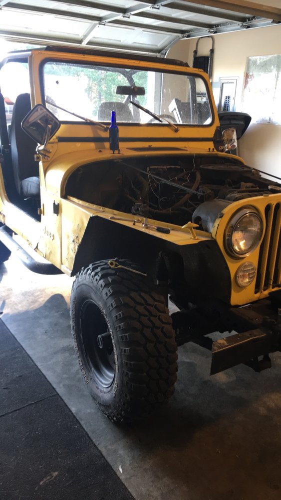

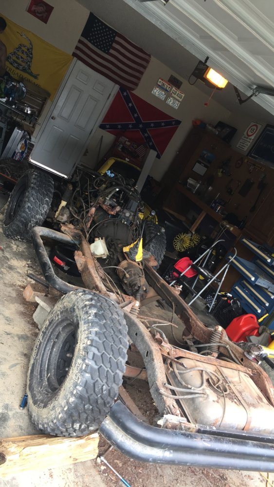

So I bought this cj7 in Michigan. The tub was completely rusted through and the body mounts had to all be cut off. Now I got the tub off and I'm having a hard time deciding which route to go. Any ideas would be great. I also have a set of Dana 60s and chevy 14 bolt to put under it when I get the tub/body/ whatever installed.

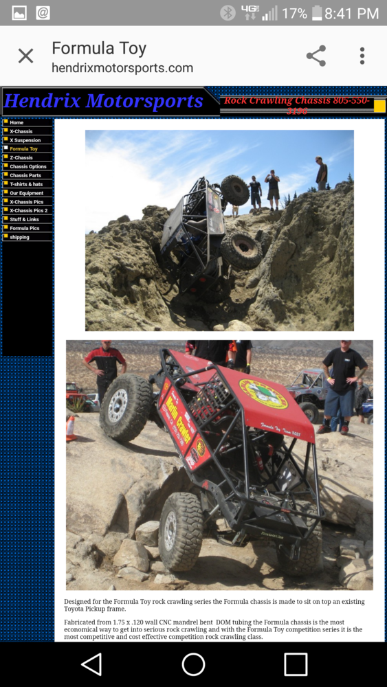

I forgot to ask. What is a formula toy.
Toyota drivetrain and frame. Add tube and walla' a very light capable rig. Companies support these so much you can literally order a prebent set of tubes..assemble and play. Hard core guys eventually four link them as well.

If you don't own a bender, or don't want to pay someone local you probably could adapt this to a CJ frame fairly easy. However a few dudes on here would really appreciate your business and dedicate themselves to the hobby to pursue a means of income.

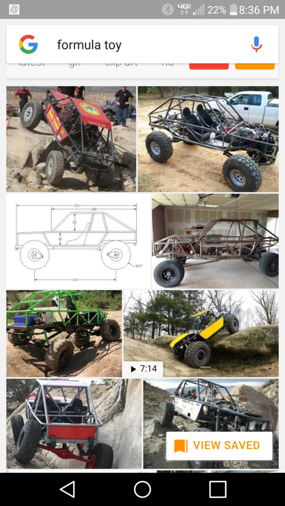

Simple google search wiuldnof goten far on my part but thanks for the info. I would like to just tube out my cj.

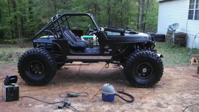

For the ammount of tube goes, a lot of it would depend on how many body panels you would want to use and if you incoorperated fenders into and what not. I've only done one full tube chassis before where I used a portion of the frame. 99 TJ tub/hood/grill with only a short section of lower frame to mount a skid to. It's involved but can be as nice as you want to spend time or money on.
In this build started nearly 5 years ago I used around 210' of 1.75x.120 DOM at an average of $5 per foot doing all the work myself on a JD2 m3 bender which alone cost me $650+ to buy. Consider it a lifelong investment though. End result I was happy with. completely SC street legal. If a 26 yo high school grad living in a trailer can do it, you shouldnt have any problems at all.
Damn that thing is gorgeous. I don't have a 600 dollar bender so I need to figure out what to use or buy or whatever. Did you build the cage and fit the panels on or the other way around. I want to have it "look like a jeep" by peicing at least hood, front clip/radiator, and fenders up front, the dash and everything , rocker/kick panel and small rear fenders like you have on yours. Yours is what I'm looking to do something similar to. Partial tub but mostly cage
Directly behind where the seats bolt down where the tub steps up into the cargo area is where I cut it. Tub and frame as if you were to take and run it through a giant bandsaw lol. The frame was also cut about even with the firewall in front more or less. Stock hood still hinged to the tub like it always was and the grille was ever so slightly raked. From multiple frame attachments I built up starting with double B pilar and out from there. Honestly if I did it again I would simply have gone with a titled tub (yj,cj,tj ), a matching hood and grille and a stick of 2x4 .188 wall rectangle tubing. This TJ I found out last minute was very tweaked from an interstate rollover which left me in a bind.
