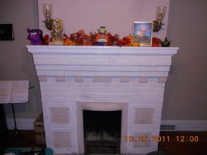

What can I do with this fireplace? Has anyone had any xp with this type of fireplace? Can anyone suggest a good chimney company that I should call? I would like to get this thing working again but this is the first one I have ever seen. We just moved into this house a few months ago and I didn't give this fireplace a second thought until now that it's getting colder at night.
Also where can I get coal if I find out this thing can be used as is? I think it needs to be lump coal not charcoal. I really have no idea what I'm talking about which is why I'm asking on here. The googles aren't any help seeing as I can't get a straight answer.

Is it a coal fireplace or a coke fireplace? Coke was semi-burnt logs, from what I understand. We had one in our house as a kid. It looked like a fireplace, just smaller and shallower. The grate was built-in and it had an ornate cast cover and an adjustable vent on the bottom. We just chopped the wood a little thinner and it burned fine.
From what we were told it is a coal fireplace but from what you described it may just be a coke fireplace. It has the built in grate, the cast iron front piece and it's 8" deep x 18" wide. Here is a picture of it maybe that will help.

This probably won’t be much help unless you have the same setup but here is what I did. My house in rock hill has a back to back chimney so it has a firebox in living room and another on the other side in the a bedroom. It had a really small firebox so I took 2 rows of brick out the back of only in one firebox. I had it inspected. Then said it had a few cracks so they don’t recommend using it but they are above the roofline so it is not big risk if I do use it. I don’t have $3k for a chimney liner so I use it sometimes. I did get a flue installed on the top of the chimney. I can’t remember the name of the company. They were ok company but I would not recommend them above another company.
Our previous house had a coal burning fireplace just like that.
We used small pieces of wood. It worked fine. If anything it seemed to heat a little better than your typical wood burning fireplace because the fire was contained in a small area right up front.
NOTE: We had fires for entertainment purposes only... It'd keep that room toasty warm but that was it. If you're actually trying to heat your hosue, get a wood stove.

Yup. What he said. that's just like what we had, and what friends had, and we all did the same thing. I think it pitched out more heat that our big-ass fireplace now, but it's still not going to heat a whole floor. It should do fine for making fun fires this winter.
I won't say that without saying this, though: Get the fireplace inspected before burning anything in it. Better safe than sorry.

I was actually wanting to use to for heat and if coke is going to do that then that's what I will rather do. Once I have a find a good place I'm going to have it inspected hopefully it checks out seeing as I love the smell of a fireplace.
Your best bet for heat is going to be to pipe in a good freestanding wood stove with a fan. You can find a good, small footprint stove that will put out a ton more heat than this. Otherwise, burn wood. It's not going to be much worse, and certainly less expensive. Still, if you can find coke, let us know. I'm interested if anybody still sells it. Seems it gets used elsewhere these days.
