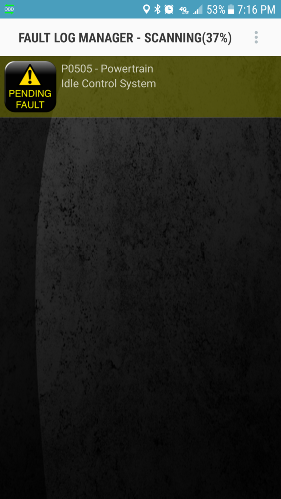

I just removed the intake on my 02 frontier to clean the idle air control valve and replace the thermal idle wax valve. The truck had been idling rough for weeks and even threw a misfire and knock sensor code. After the repairs this week I started the engine for the first time tonight. It idled great but this code popped up. Any idea what I could have done wrong?

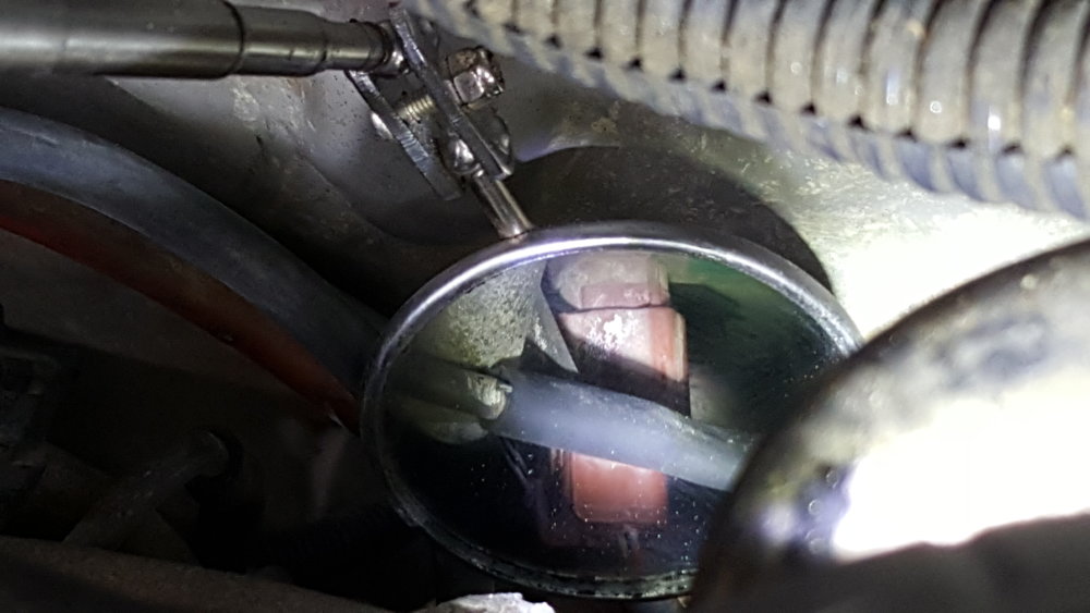

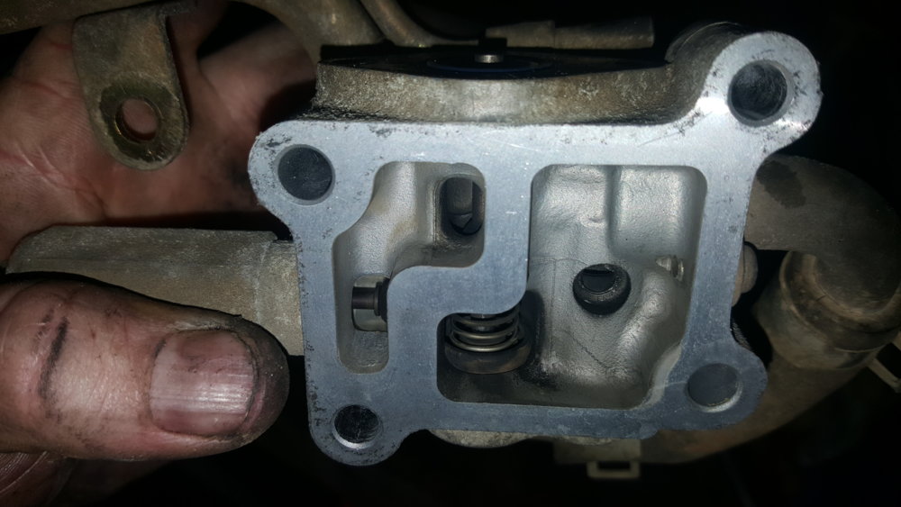

Are you referring to the plastic part with the electrical plug? The part of the valve I cleaned was the one with the ports and springs.
