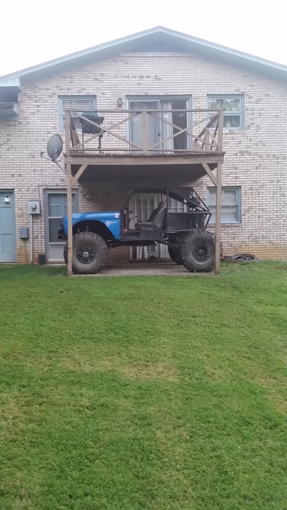

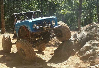

Looking to put either coilovers or air shocks on my bronco. The frnt already has coilovers but rear dosent weigh alot so think air shocks would be ok. What do you guys think. And thinking around a 12 to 14 inch travel.
