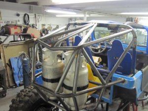

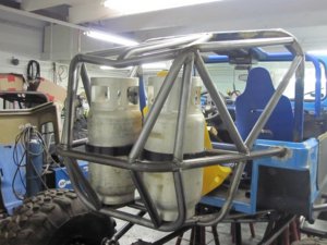

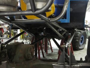

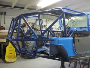

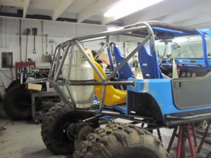

rear
rear is basically done other than finish welding and mouting the seat and sway bar. also waiting on bump cans to show up.

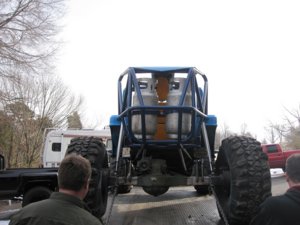

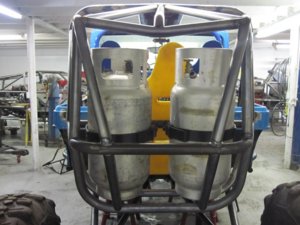

How do you get the propane cans in, looks awful tight to getting them in. I'm liking the build though.

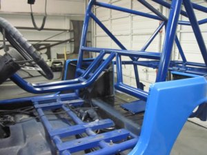

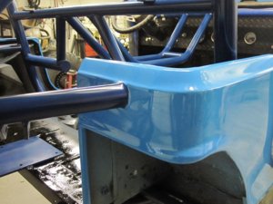

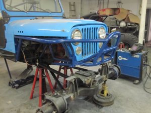

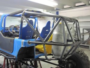

getting close to being finished with my part of this build. sprayed some paint, and reasseble things tonight.

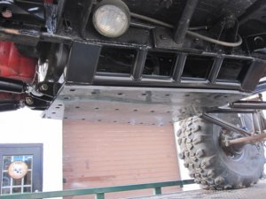

build looks killer! something to think about, if this rig is going to get beat on i would consider plating the frame at the engine mounts. If you remember at mtn city back in august when i killed my dshaft, when i backed off of that rock and caught the steering box i killed the frame at my engine mounts. It dimpled up on the inside.
down the road.

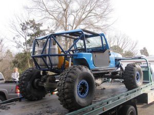

We work on her to day still a lot to do all donations would be great
Looks great guys. . .Cant Wait to see it back on the trails
what size heims are those tim? 7/8?
got a little more done this week looking good but still alot more to do
