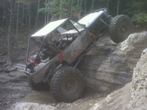

I picked this up a couple of months ago from a guy up in Maryland. He ran werock competitions last year. The chassis was originally built by campbell enterprises. I got the chassis, motor, and skins from him. The drivetrain is a jeep 4.0, TF999, Klune V, and a dana 300. 60 front 3 linked with air shocks and bumps. 14 bolt rear 4 linked with air shocks. Hoping to have it out on the trails this summer.

took it over to a buddies to do some final welding. 5'10" to the top of the cage at full bump.

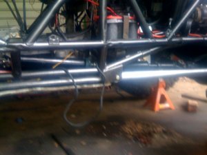

Got this thing together last fall and took it out a few times. Over the winter it got a few more changes. I got peer pressured into shaving my 14 bolt... I couldnt say no. The bottom of the cover on the ballistic shave kit was a little sketchy, there wasnt much material, so we added so we added a little material to it.

Got some new shoes for it too... 42" Pitbull Rockers on 17" trailreadys...
Putting in new seats and making a little more leg room as well.
