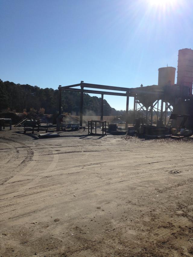

At the blaster

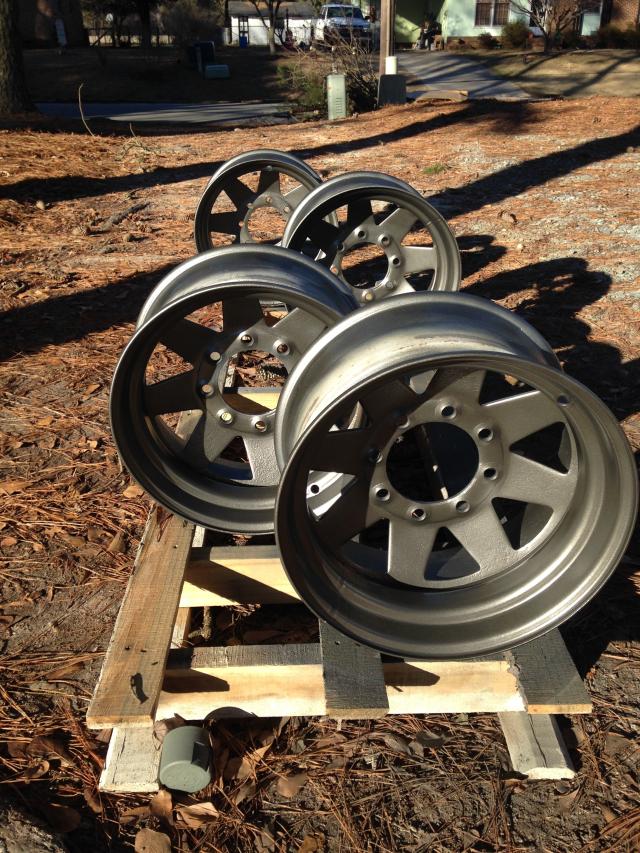

All blasted and ready to go

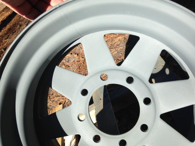

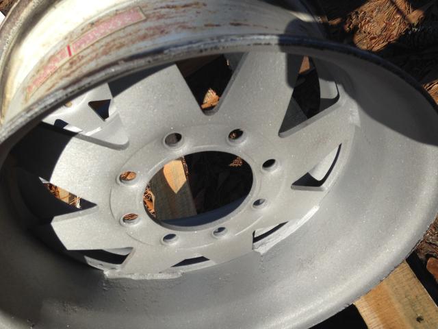

Etching Primer
ai7.photobucket.com_albums_y252_ponykilr_1D24EB2C_3497_4D3A_97E9_52A9B64E4D5A_zpszt8rmddh.jpg
Sealer
ai7.photobucket.com_albums_y252_ponykilr_FD1D6EB3_E32C_42BF_B4EE_E48685D95243_zpssasiqh60.jpg

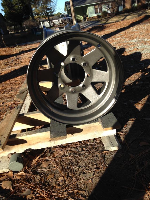

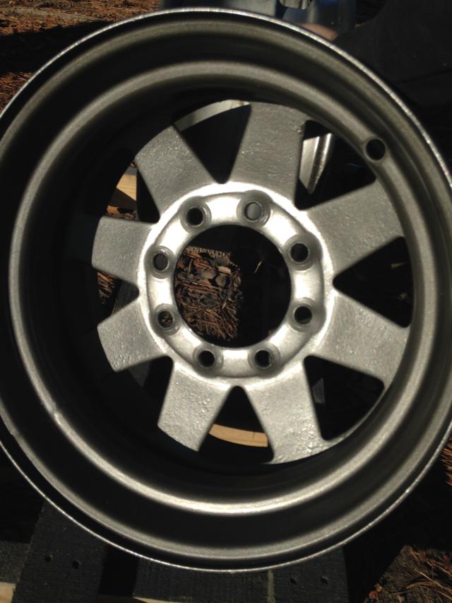

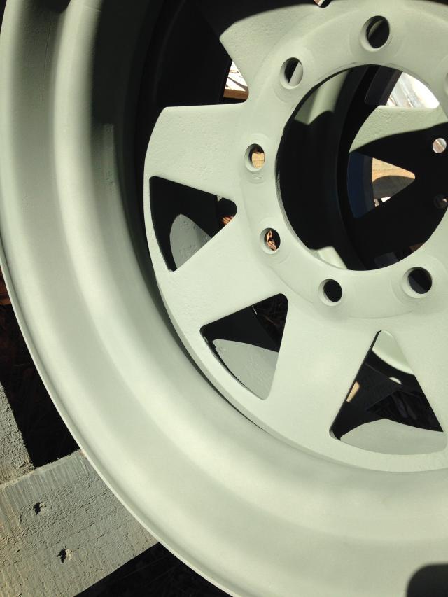

VHT Cast Iron Gray Enamal
ai7.photobucket.com_albums_y252_ponykilr_DD88552B_8F3C_4DDB_8AF0_EEE42DFC7D65_zpsj8iu41vm.jpg
ai7.photobucket.com_albums_y252_ponykilr_EDD0740D_1B24_4187_86F0_8544521FF0E7_zps3cmh7nty.jpg

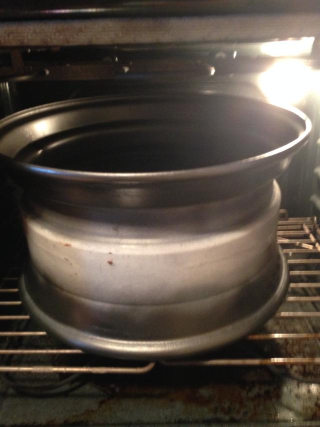

Baking in the oven. 200* for 1 hour to cure the enamal
ai7.photobucket.com_albums_y252_ponykilr_DADB1E80_F489_4011_A988_D990B10D1793_zpsrrvicf38.jpg

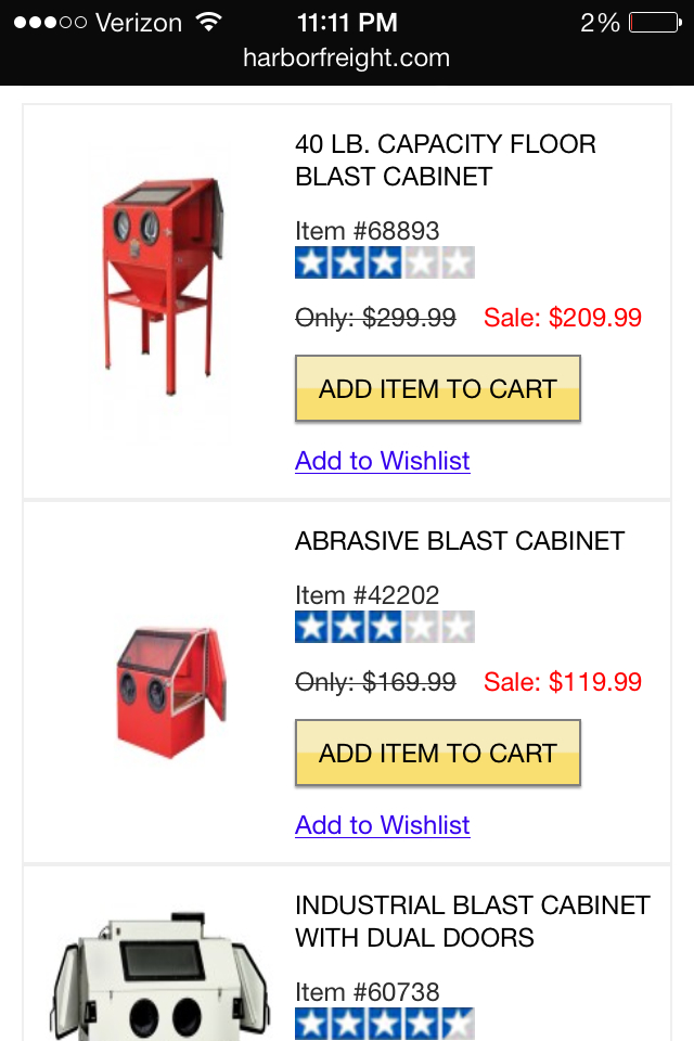

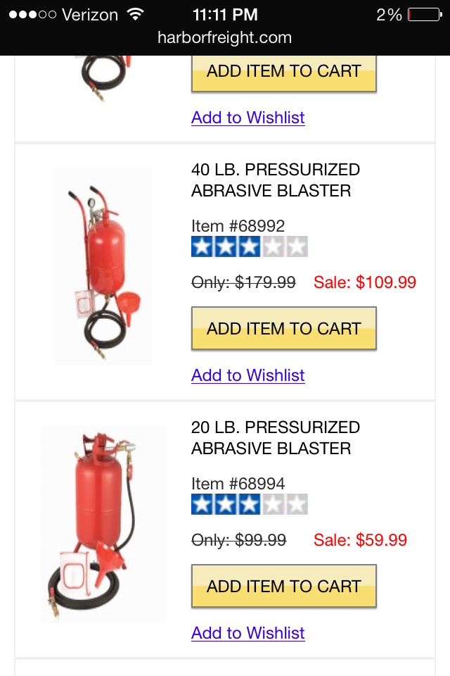

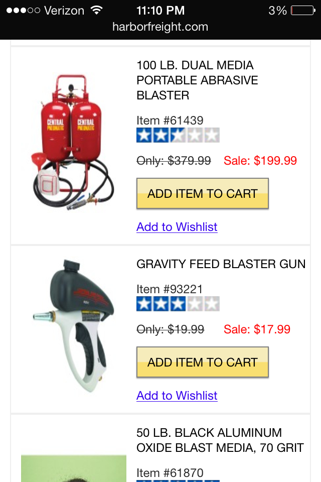

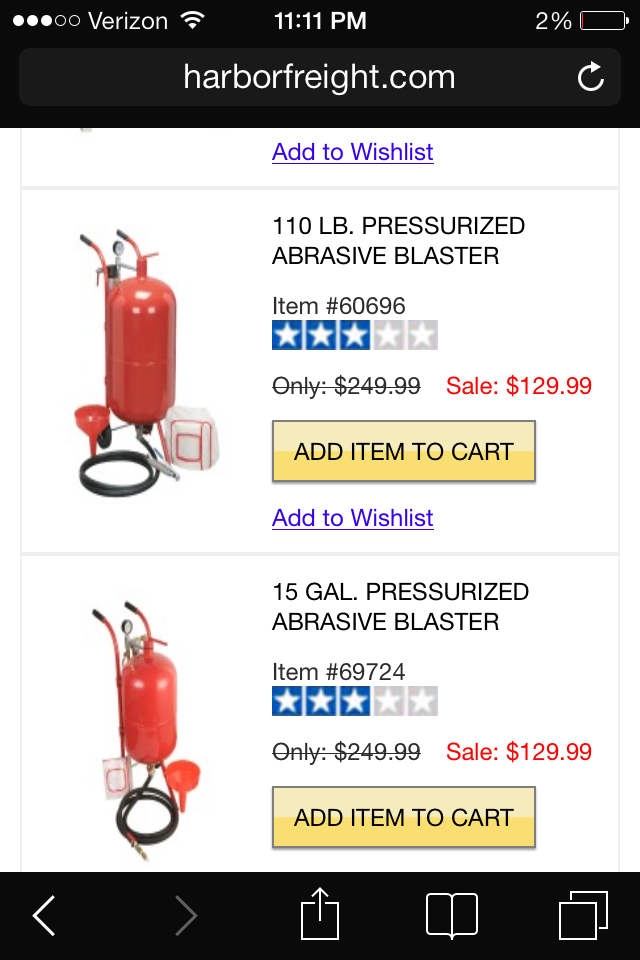

Harbor freight has a two pot pressurized setup on sale currently. Seen it yesterday. Just an idea, you could get that and then build a cabinet.
