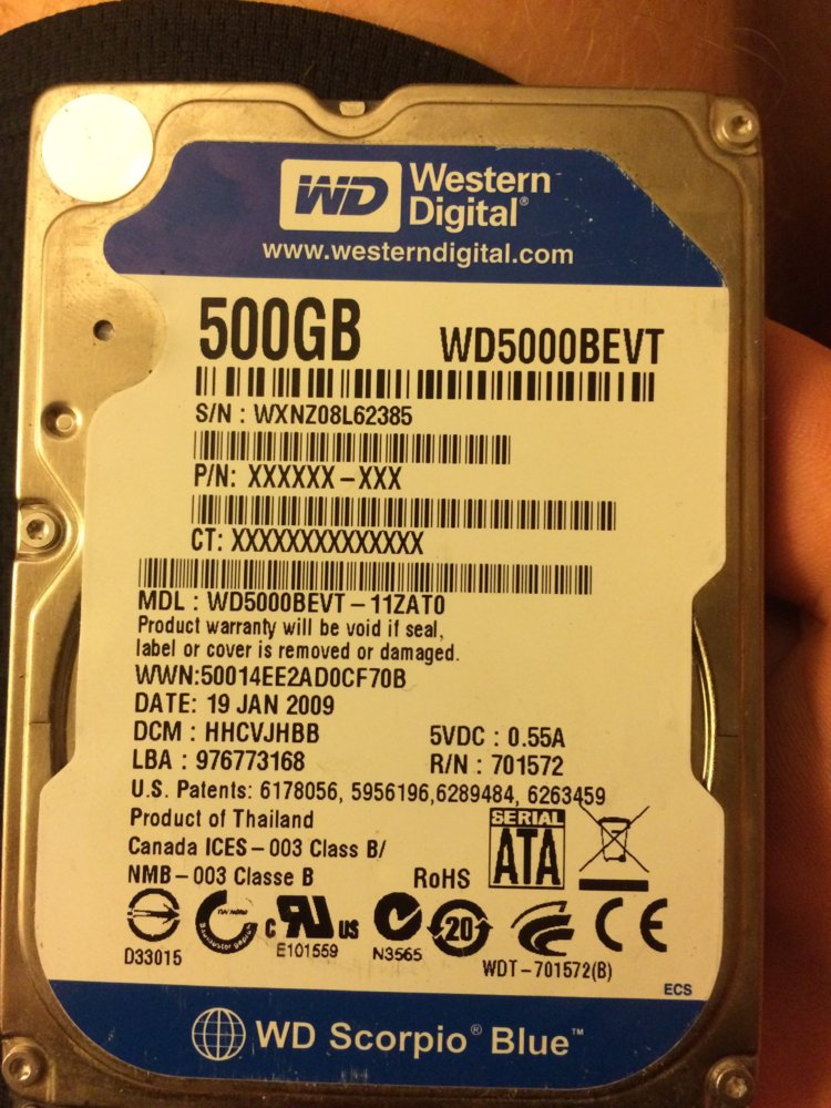

I am by no means computer savvy!! I know the basics and that's about it. My problem is I had an old dell laptop and it got broken to the point I could do nothing with it but I pulled the hard drive as it has a lot of pics, music, and movies on it. How do I access them now? Can I buy a hdd enclosure and just plug it into another computer? For what it's worth it's a Western Digital 500 gig 3.5inch hd.
You can buy a USB interface cable and get whatever you want off of it for cheap, or put into an enclosure for $25 and make it more permanent for barely more money. Either way, it will be an interface/adapter board and a wall wart power supply to power the drive.
Also, that looks like a 2.5 inch drive, which would make more sense for a laptop. If that's the case, they can some cables/enclosures can be powered off the USB port if the drive is low enough power. You wouldn't have a wall wart for power basically.

Borrowed an enclosure from a friend till my docking station arrives. I have been able to look at the information (pics and such). I tried plugging the drive into my PS3 to access the movies and no dice. It doesn't even populate on the PS3 main screen. Fwiw on the dell HD it was an admin profile and login and it popped right up on the screen as e:drive then :user then choose appropriate file. Seems too easy. I'm going to get another hdd and copy the movies and see if I can pull them up to watch. I don't have or believe in paying for cable of any sort so we watch movies every once in a great whil around here. If it's a no go then so be it but at least it seems I'm able to access the pics and that's what I care about the most.
Yeah, it's all there. But make copies of the data, starting with the photographs and whatever else is most important. That drive is almost 9 years old. Lifespan on a WD Blue like that one is 5-7 years.
