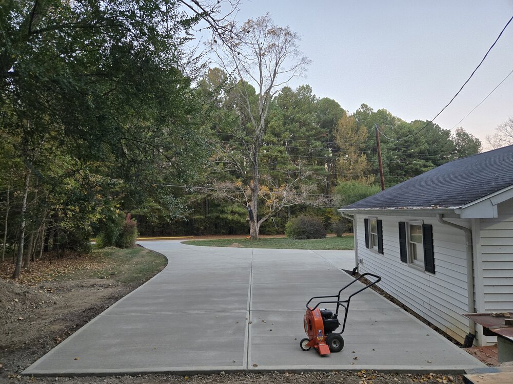

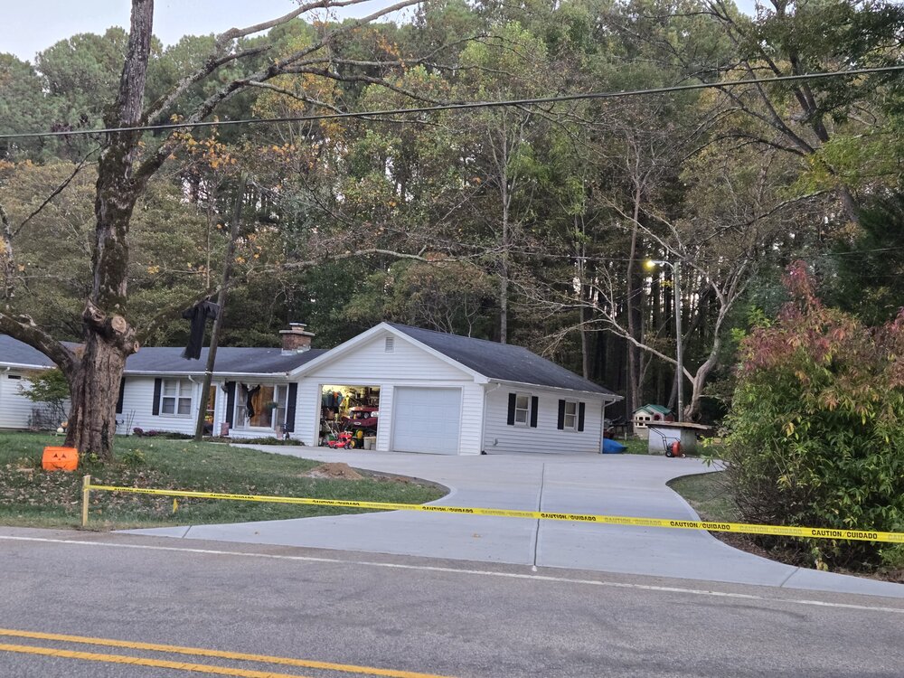

I ended up going with the first contractor that came out. A few others looked at it or reviewed my RFQ but I never received any more actual quotes. Even had one refuse to quote saying that his gigantic Takeuchi tracked skid steer would not be able to scrape off the gravel (I ran into that joker in the neighborhood behind mine). The one that did the work showed up with a mid sized wheeled unit that did the job just fine. Prepped day one, poured day two, stripped forms morning day three. Ended up measuring it at ~3180 sqft. I have a bunch of backfilling to do around the edges and to finish the trench and drain pipe it to the road but it will be nice to finally work on a concrete drive than gravel and not track crap into the house all winter.
I finally get to park on it tomorrow! Was waiting for it to cure, kept blowing it off and wetting it down.
Congrats!
Looks good in pics
