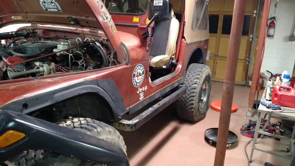

Like said, if it's sealed, you got more work to do. When I moved in, my basement was clean concrete, & un-sealed. Water would seep into it. When it's sealed, the water just pools & sits. I Still washed it down, brushed & washed again with Muratic acid, & washed & rinsed Again. Per instructions of my Stain seller. Then I rolled on 2 coats of sealer stain. [clay brick color] As with any painting, Prep was the hard part! It has held up well, even where I do most of my fabrication work. Mine didn't penetrate as deep as I thought. I have scratched through with creepers, & dragging metal objects! But otherwise, it's still sealed. Should work good around the pool!
[Here's a sample of my floor: not the truest color]
