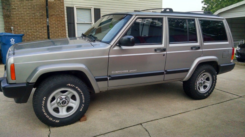

Contemplating going to Pull-A-Part and buying trans/trade axle linkage and such. What about computer? Will the swap mess with anything electrical?

I have a unicorn. A 2001 XJ with less than 90k. If it were 4wd I could triple my investment easily. I can almost double it today. This is the Craigslist crowd but not the nc4x4 crowd. Buying a donor Jeep for $600 (which I have) and swapping parts I could resell the donor Jeep for say.......$600. All I'm out is time in my garage away the world!
