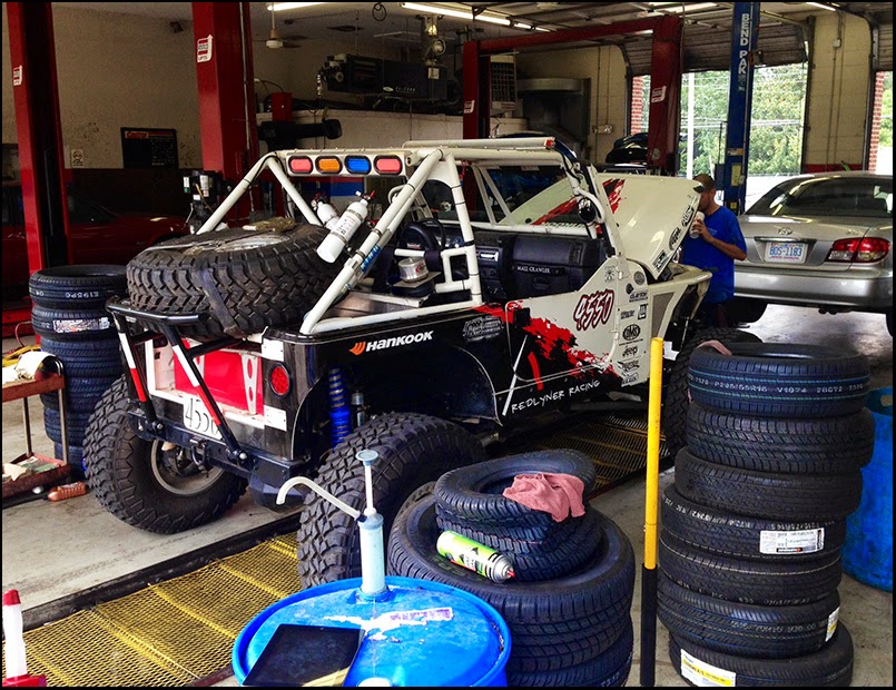

So far so good..... Radiator cap seems fine, no leaks can be found, and initial testing shows the head gasket is ok. Looks like the main culprit was mud caked in the condenser. We've had a hose on it for awhile breaking up the mud and after a few test drives, no over heating. I'll probably have to experiment with it and do some climbs or idle with the nose up in the air to see if I can get it to replicate. Yesterday I was flooring it and manually shifting gears at redline (getting some 0 - 60 times.... they were slow), so maybe I can try some more of that to get the coolant boiling again.
alh6.googleusercontent.com__KuzuTCaDJqE_VACod5pG0QI_AAAAAAAAFL4_6PoX0muCKJU_s805_emissions1.JPG
Also, for reference, here is a shot of where I trimmed about an inch off the upper section of the shroud (old engine mount setup had the fan blades clipping the plastic on hill climbs)-
