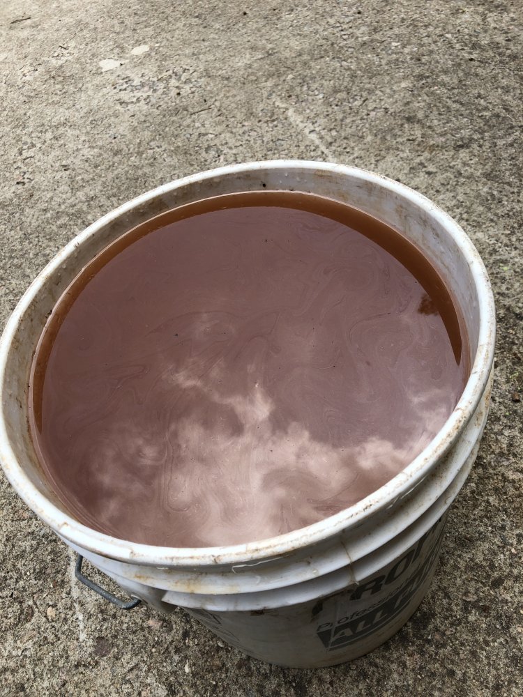

The cooling system was REAL BAD. Here’s a pic from the first time I dropped the coolant
Rust and TX clay...
The engine block is still sloughing off rust flakes, clogging the radiator.
