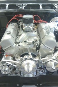

Not a 4x4 but I though you guys would like it. This is the 3rd car built for this guy, 55 Bel Air, 61 Vette and now a 67 Camaro. Car was originally a 302 DZ but the owner wanted a lil extra. Yes it could have been a concourse resto but it is his $$$. After you took a 61 Vette 283 2/2/2 Glide combo and junked it for a 385 Ramjet you relly dont give a shit about history.
Specs:
Perfect body- had been lightly hit in the pass rear at some point but still got new pans, new glass, ect.
Chev ZL1 427 #287 of 427, Tremac 5 sp, 12 bolt Moser Chromolly axles/Detroit 18"/17", alum fuel cell, blah, blah. Will be black leather and yes this thing will be driven and abused I assure you. Enjoy the crappy cell phone pics, more to follow whenever I get to Hiddenite.

Those Anniversary ZL1's are good motors, we've got engine #1 in our shop '69 COPO.
Any plans to ditch the leafs, maybe in favor of a Quadra Link?
Looks nice btw.
Bad ass ride right there boys!
this is my dream car to build one day but cant afford to with two kids. Have to wait until there grown and gone first so until then i will just keep building toyota trucks. Much cheaper and still alot of fun!!!
well if he had to ditch the 302, the ZL1 is badass enough to make it ok (the vette on the other hand...). btw, what is gonna happen with the 302? ;-)
Sold it off to one of the owners friends to put in a resto early this year when it was pulled. We tried, just like the Vette, to concourse resto. Dude just isnt into that
Looks nice btw.
It is in the discussion ES. The last one was a 4 link w/ Strange co and it handled like a go cart on steroids.
