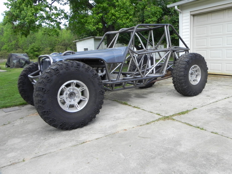

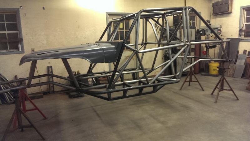

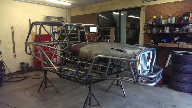

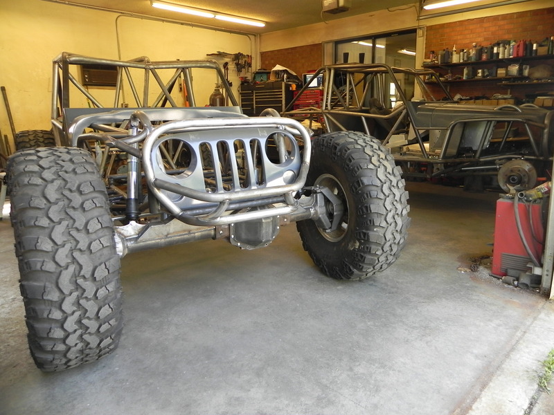

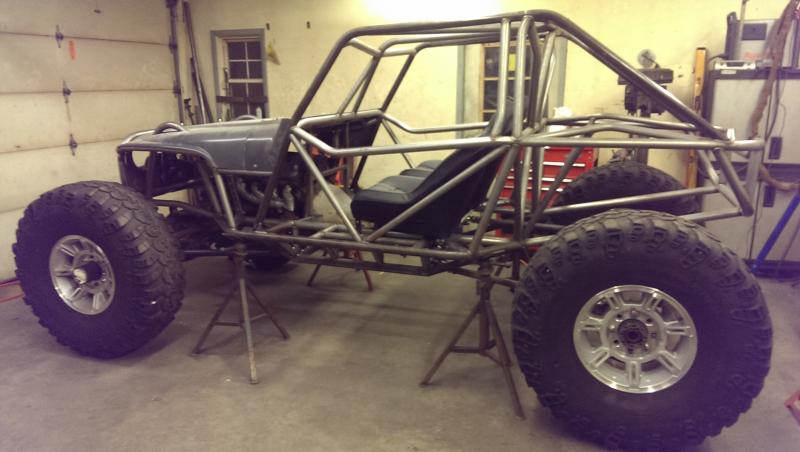

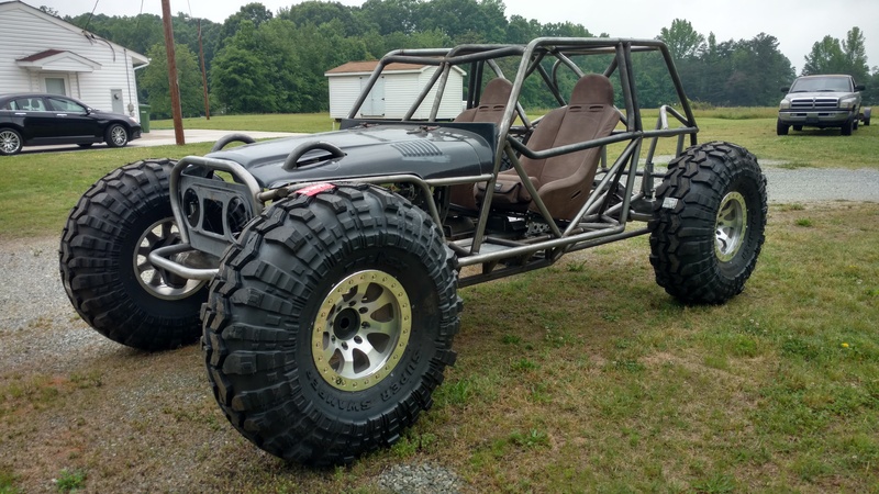

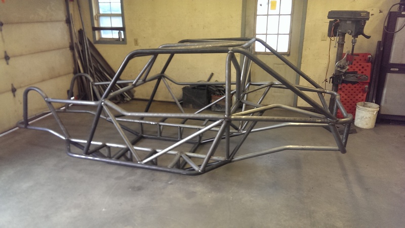

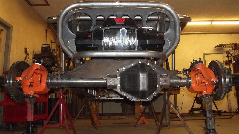

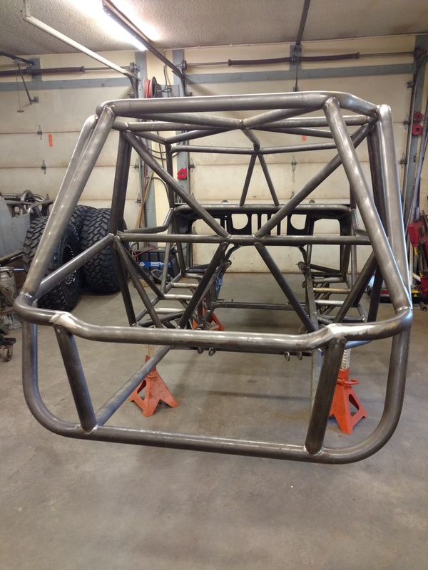

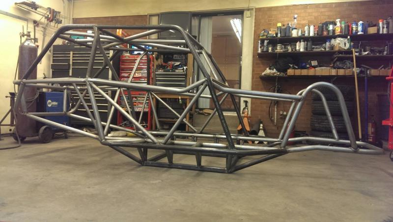

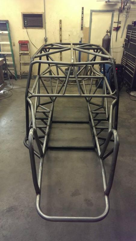

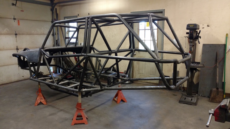

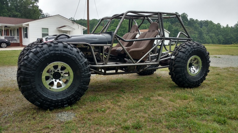

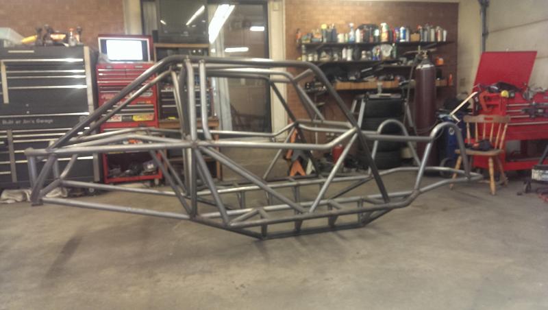

Couple more chassis to add, got to stay ahead of PJ.

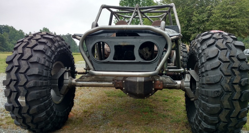

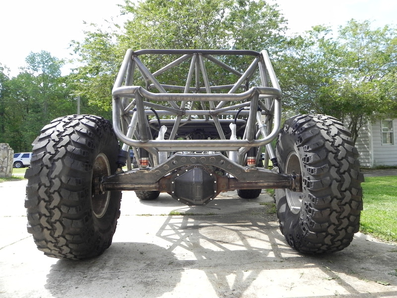

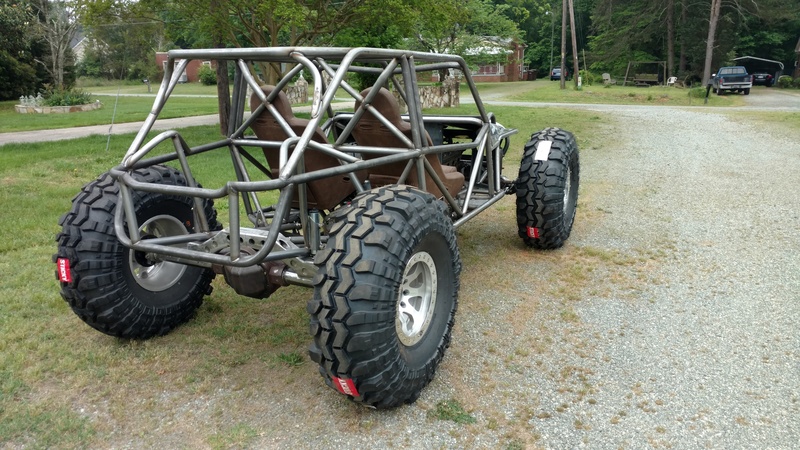

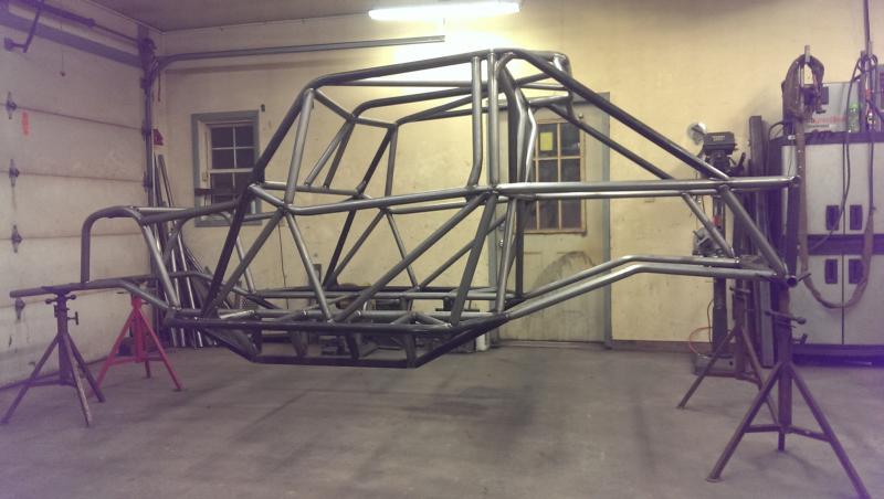

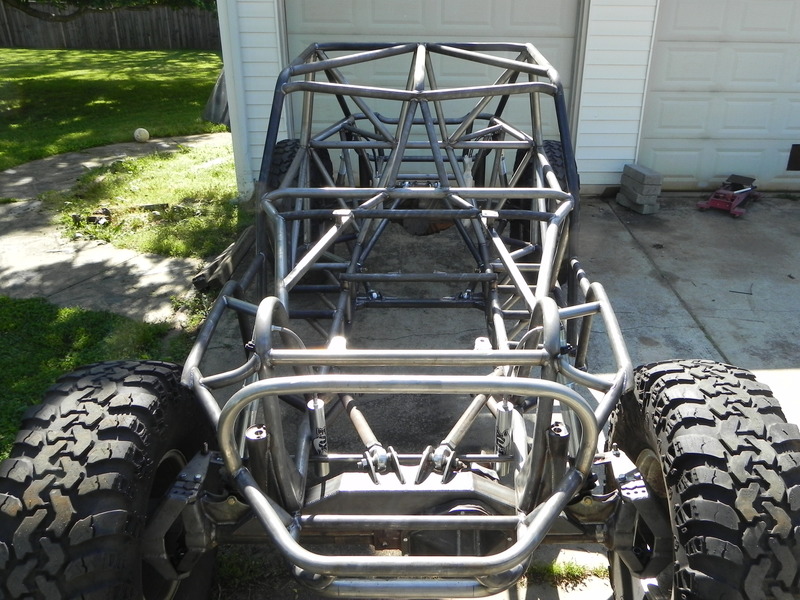

#26 went to TX a few months ago with mounts for an LS, th400, atlas, and link mounts. 54" wide with steel CJ front clip.

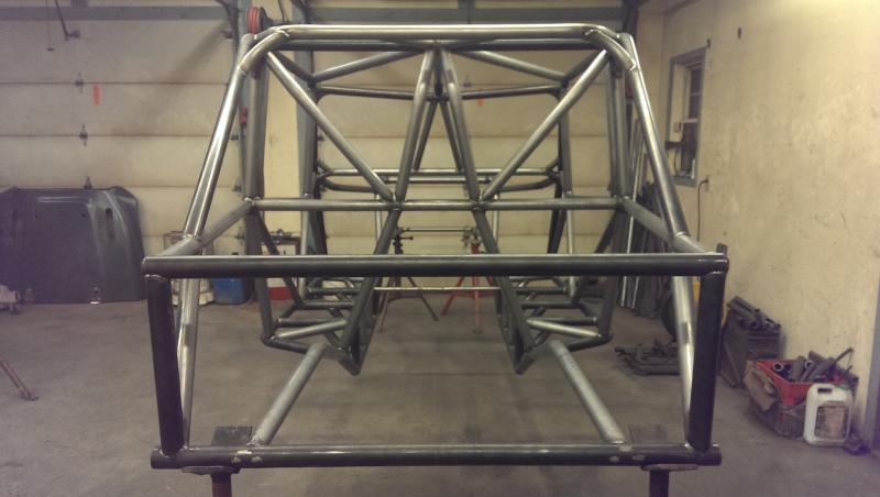

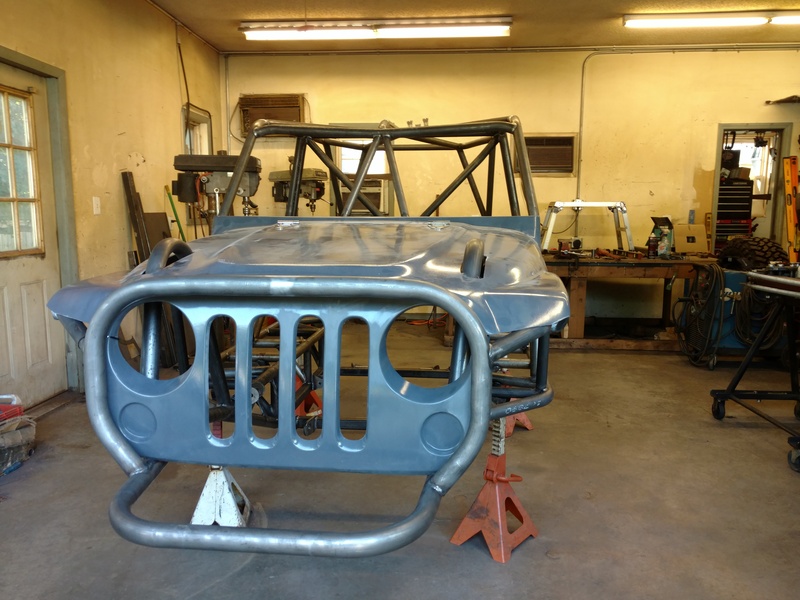

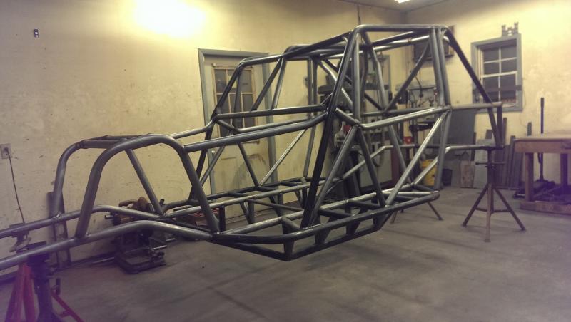

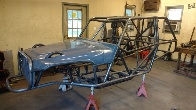

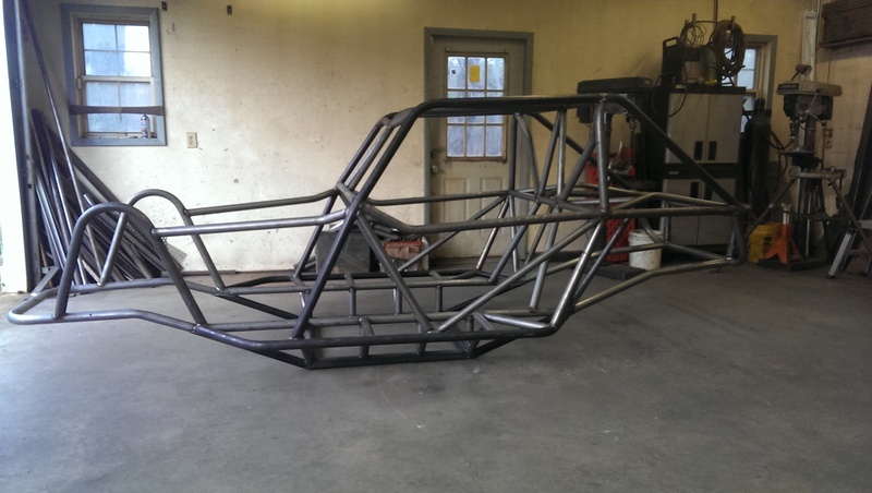

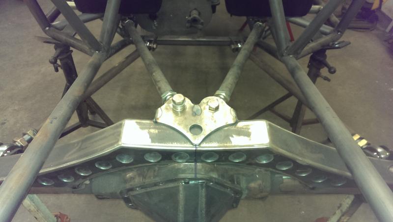

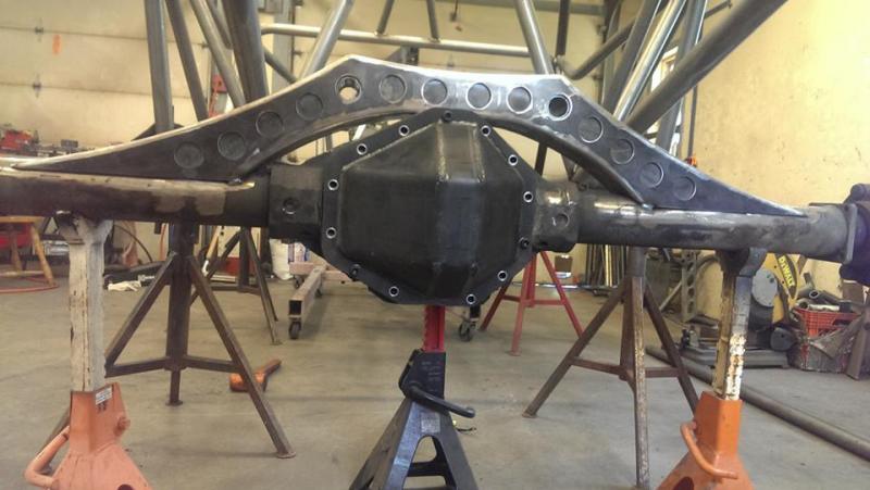

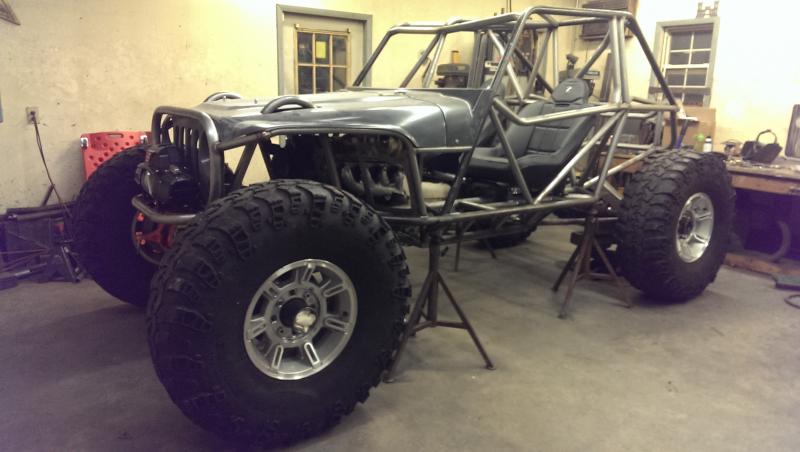

Been working on #27 when I'm not making things happen in Mocksville. 54" wide with fiberglass JK clip. All the dark tube is .188. The rest is a mix of .134 and .120 wall.
ai68.photobucket.com_albums_i17_rockmafia_10626159_758124590910fd8231c043123c93626c758da813b38.jpg

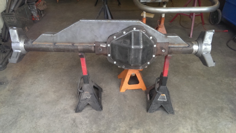

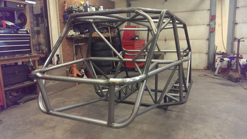

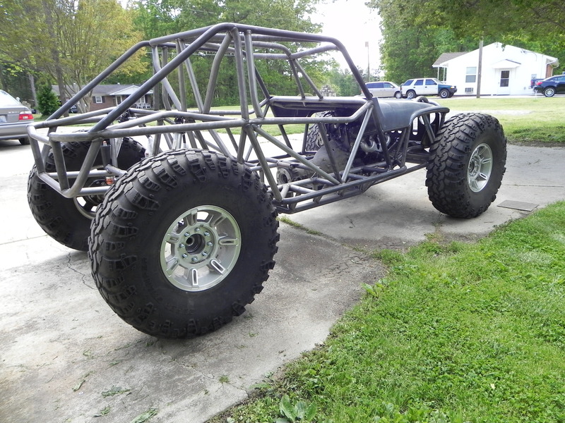

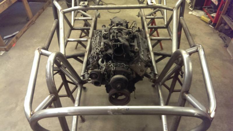

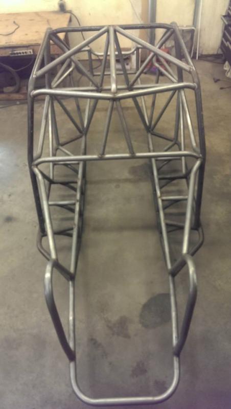

This one is getting an LS3, th400, atlas, and 14 bolts f/r
ai68.photobucket.com_albums_i17_rockmafia_10686636_758127177586a52858ff2679b305b1e775a94c1e2c9.jpg
That last pic is bad freaking ass.
Awesome looking rig, killer fab work!
Looking good Jim
