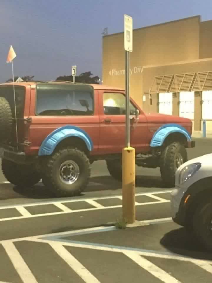

The truck also failed because "the truck needs fender flairs." I know I've seen vehicles in the area that have oversized tires, so was I just targeted by the inspector, or is there some law I need to be aware of in PA?

My wife's from up that way. And every time we go to visit I see some pretty cool rides with the most hideous homemade fender flares. So I thinks it is a law up there.

Fenders have to cover the tires. Same as MD. Doesn't matter what the fenders are made of. The classic test is for a patrolman to lay a qatrer against the fender and roll it down, if it hits rubber it fails.
Now that said, functionally speaking people get away w/ it all the time. You may need to just borrow something from somebody, tape 'em on, pass, then remove them.
