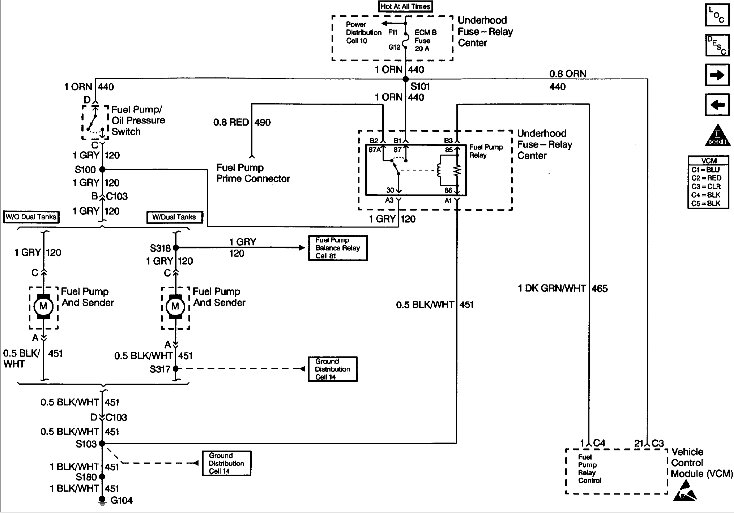

Has anyone ever seen the Crankshaft Position Sensor cause the fuel pump to get no power on a Chevy 5.7L motor? I have no power to my fuel pump and I have replaced/checked fuses/relays/oil pressure switch. Any thoughts or help would be great. Also I am not seeing any wire damage that I can see. Tested motor with gas in the intake and it ran so the motor will run but no fuel pump power?
While I can't tell you much about your aftermarket harness, I can tell you about the factory wiring (in which nothing in relation to the ckp can cause a issue with no power to the fuel pump).
In the factory wiring is a basic relay setup, when testing this type of system you'd expect to see in running conditions 2 12v pins, a ground pin and a load ( the fuel pump) - I'd say your painless is very similar. So start with your relay and check for the basics!
The fuel pump needs to have power to start the engine, and the engine needs to rotate to detect most operational crank position faults (except short/open sensor signal), so the crank sensor will not prevent the fuel pump from getting power.
