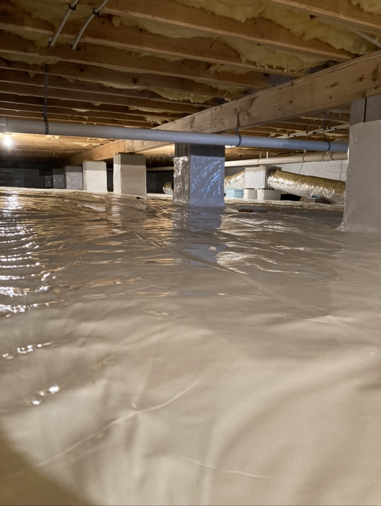

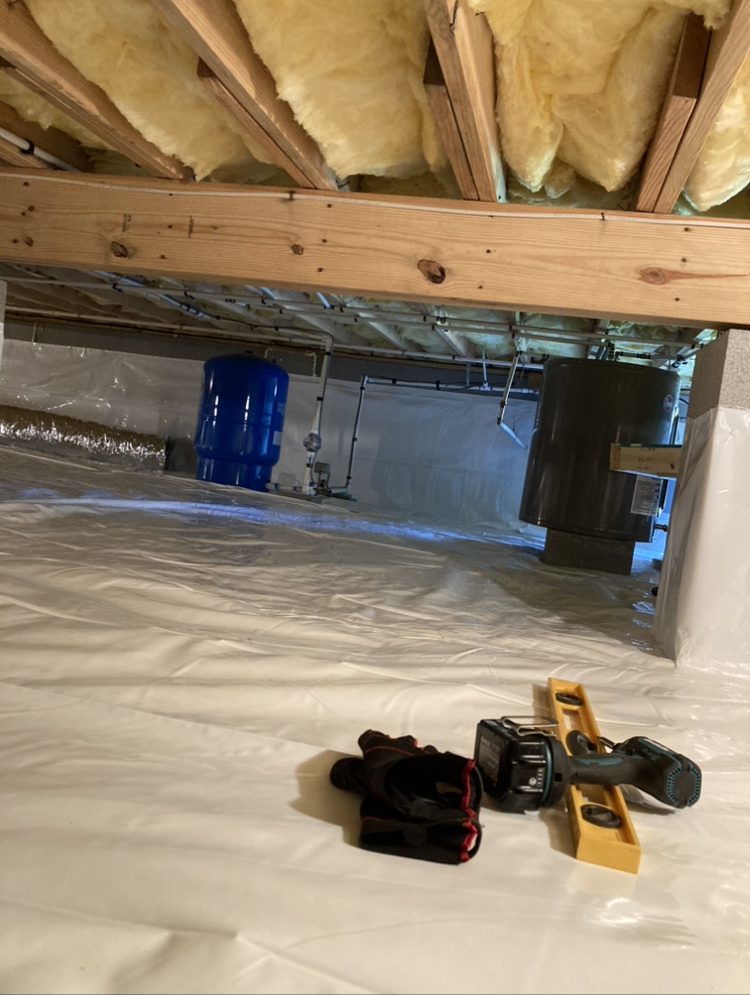

Hey, since this thread was brought back up let me post a couple of pics to show what I finally had time to do. The Keystone is now my backup. I bought all my stuff from crawl space ninja. Installed an Aprilaire dehumidifier, vapor barrier on ground and walls, and watch everything on a therm pro monitor. The worst part was cleaning every floor joist and the rest of the floor with white vinegar. Freaking killed me. No, the worst part was waiting for all the new skin to grow back on my soft tender parts after the vinegar had its way with me.
View attachment 399881View attachment 399882
I think I officially just became an old man…I got crawl space envy. Nice work!
