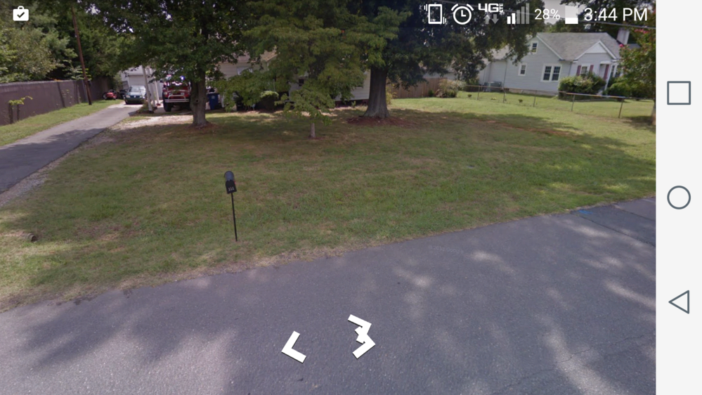

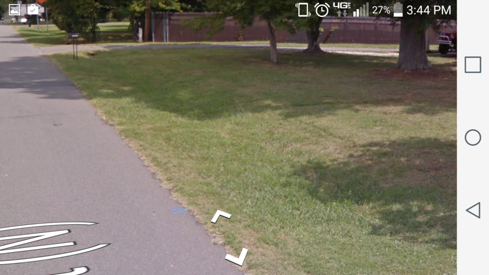

Here are some google street views of the existing pipe under driveway and I'm looking to add an unpaved driveway on the other side along the chain fence. Its not very deep but is deeper than pics show.

That shallow, I wouldn't use corrugated plastic.

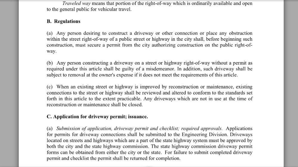

Looks like Winston has published its design standards which includes driveway standards and specifically mention residential driveways requiring permits, etc and shall adhere to their general standards for design, construction, and permit requirements. There is even a section that covers multiple driveways.
