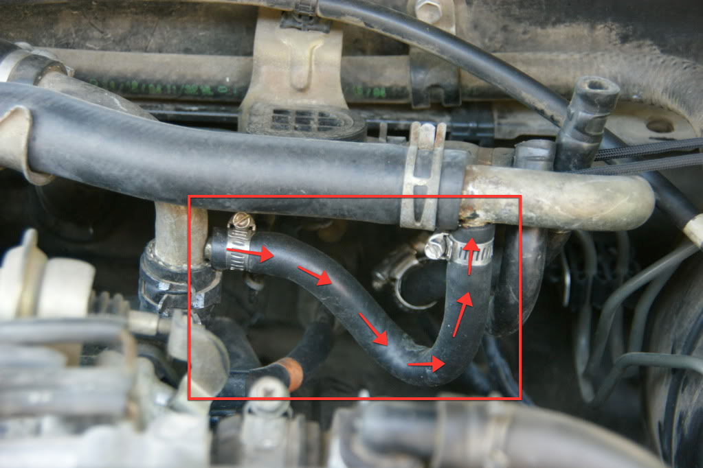

Highlighted the bypass location (image from the thread posted above) for clarification... does this look right?
if you plan on keeping the heater in place, what you did was fine, but won't help your heat much if you leave it that way, as the coolant will bypass the main core in the dash.

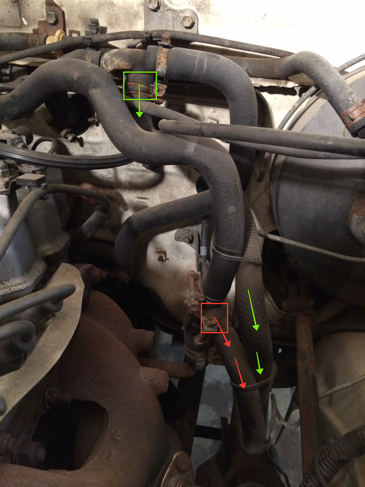

I haven't done anything yet. Here's a picture of what I'm looking at coming out of the firewall.
The red and green arrows show the 2 tubes that run under the truck to the center console. I've also marked with boxes the 2 spots where they fork from the main lines.
What I'd like to do is just remove these from the whole scenario so that I don't have anything going to the center console, and can remove it. Thoughts on what to do?
yes, remove the T's, if I remember right, you can did it with out buying or adding more hose, you'll remove the T and a short section of his past the T, then re-connect the hose from engine to dash heater core
be careful, that core is 28yrs old, and pretty brittle, it won't take much to make it leak.
Alright, I've hit a bit of a blocker.
The T in green is actually a part of what I believe is the heater water control valve. Given that I want the front heat to still work, I'm not sure what exactly to do.
