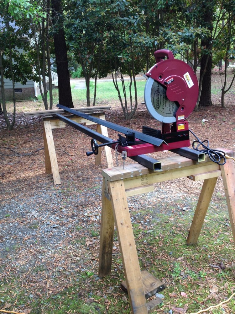

This is my current, portable, temporary setup. Worked really well. Will post some pictures of the cuts that it made a little later today or tomorrow.
Picture after the cut on the angle. No cleanup. Clamp holds material strong enough I could pick up the saw with the material.
Not sure how well it comes through, but if you can zoom in, you can see a few chips on the table and a small bur on the bottom left edge of the angle.

These are the pieces I cut. There has been zero cleanup on them. No more cleanup than they need, I could just use a sanding block with 120 grit and be done in no time.
