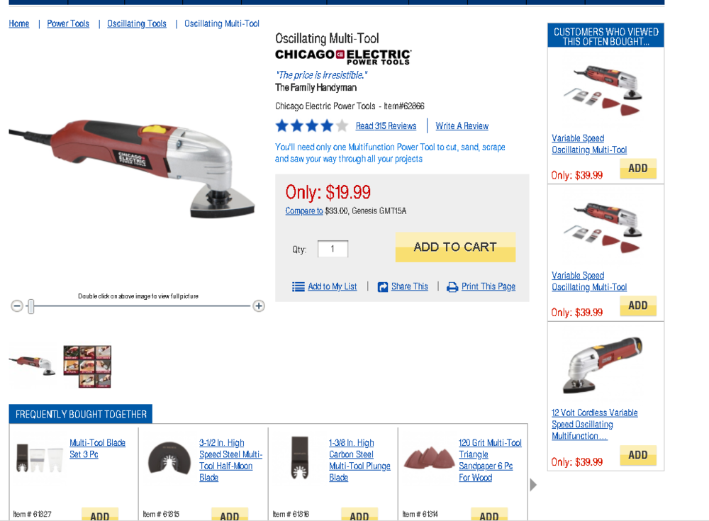

$20, comes with the blade you need:
Oscillating Multi-Tool
And the blade might even last through the entire cut! Some of the name brand blades at Lowes/HD fit these (Rockwell maybe?) so you have options for better and different blades. I bought one of these like 5 years ago to make one cut. Rarely use it, but when I do, nothing else will suffice. $20 well spent.

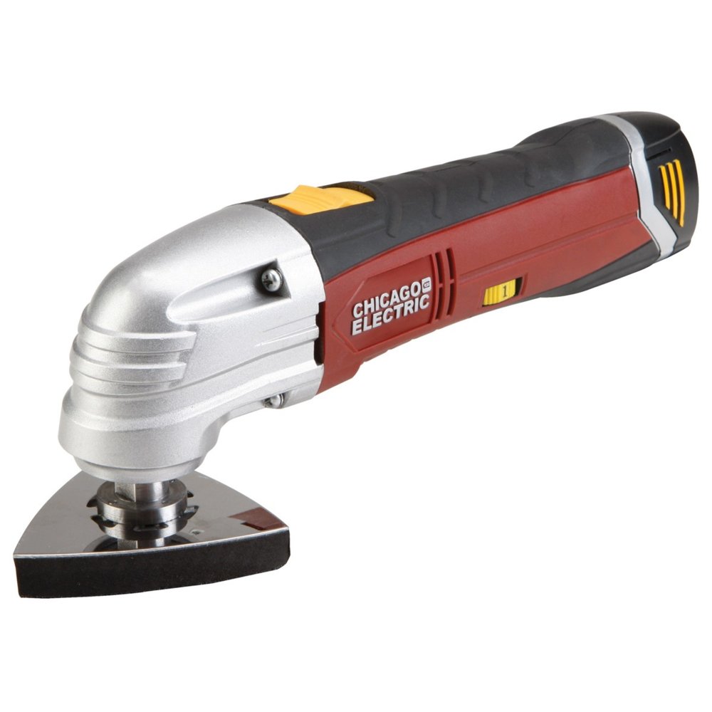

No case with mine. And buy some good earmuffs, its loud! The variable speed one is probably much quieter. Mine has 1 setting, WFO. If you're looking for an excuse to buy nice 18 volts tools, I know Milwaukee makes an 18v and 12v version oscillating tool, but it ain't cheap. I would have one if I didn't already have the Horrible Freight version.

Like this?
My variable speed spends the majority of its life WFO, too. No, it's not particularly quiet, but dammit, it does the job!
