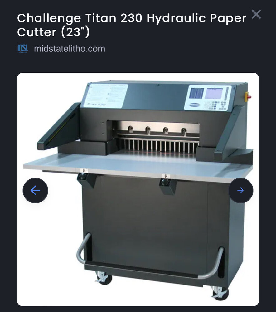

I feel like the one you're talking about is the office machete on a hinge? The ones they are talking about or at least the ones I've seen are hydraulic with 2" thick steel tables

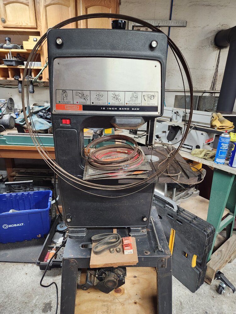

Just incase you need a bandsaw with a large assortment of blades! lol
This is for sale in the misc section on this forum

I used to cut 6” stacks of paper and ours wasn’t a big machine.
What’s more impressive than the thickness it’ll cut is when you can shave the edge of a stack and take off 1/32”
