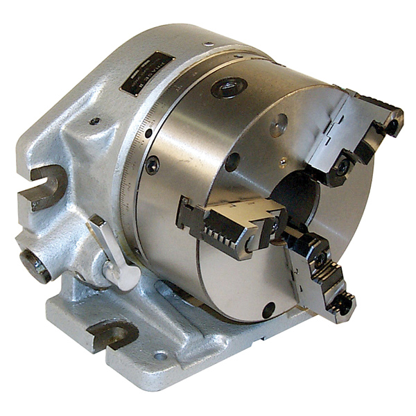

iam now using a super spacer and my mill, i run the tubing through the back side of the chuck on the super spacer the chuck rotates 360deg and the tilting up/down or leaning left/right of the mill head combined with x/y table movements i hope i can leave the arm breaking 1/2' dewalt alone.

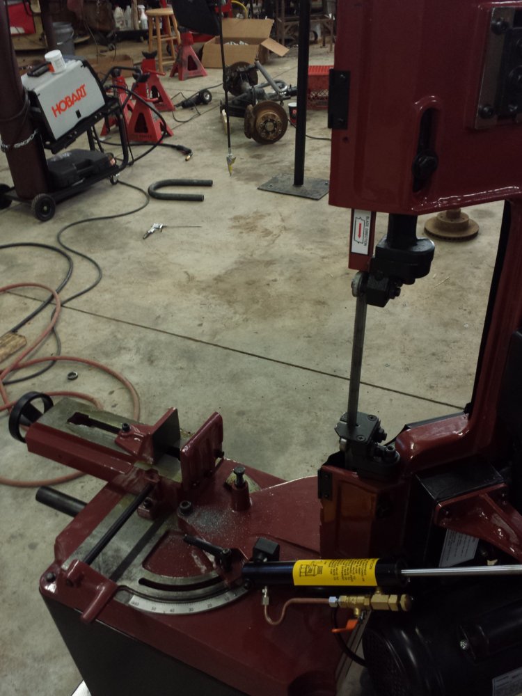

Ended up picking a 5x6 band saw from northern tool for a little less $500 with the discounts I had. The stand leaves a little to be desired but the saw itself is great
Ended up picking a 5x6 band saw from northern tool for a little less $500 with the discounts I had. The stand leaves a little to be desired but the saw itself is great View attachment 175801
I've never seen that one. That's a good looking saw! The vise is much nicer than what you get with a 4x6, and the swivel head is a great feature.
