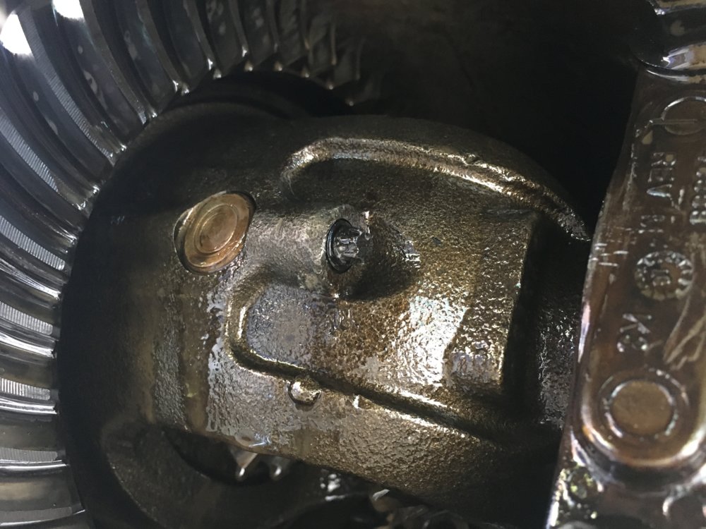

Daily driver that I picked up cheap it would cost more to swap an 8.8 in that the jeep is worth only to have the same issue with a stupid freakin screw through the counter shaft.8.8 swap?
Not to derail this but aren't most diffs like this? My 8.25 is, to my knowledge a dana 35 is...Daily driver that I picked up cheap it would cost more to swap an 8.8 in that the jeep is worth only to have the same issue with a stupid freakin screw through the counter shaft.
240k miles... the shaft is going back in.
Probably a mix. Most I've dealt with were a sensible roll pin.Not to derail this but aren't most diffs like this? My 8.25 is, to my knowledge a dana 35 is...
C-clip axles will usually have a bolt, semi and full float axles will have a roll pin most of the time.Not to derail this but aren't most diffs like this? My 8.25 is, to my knowledge a dana 35 is...
