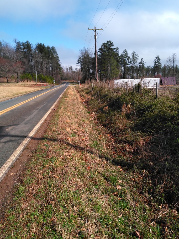

Another thing I noticed. There is a ditch on both sides of the highway that runs down hill along my land and theirs. Both flowed down to the larger smokey creek. They flowed like that for a long distance going through pipe under each landowners driveway. My neighbor didn't put a pipe in that ditch to allow runoff to reach Smokey creek. They just filled the ditch and diverted runoff 90 degrees down their driveway ditch to a road pipe down there. So now all that water is not going to SC...it's going under the highway....joining the spring water and running through my land then into SC.
If you have any saving grace, this may be it. NCDOT has very distinct rules about not changing drainage from the road ROW and has specifications and permit requirements when constructing a driveway that ties into a state road. In this instance, if the landowner doesn’t take action to correct, a call to the regional DOT engineer would remediate this.

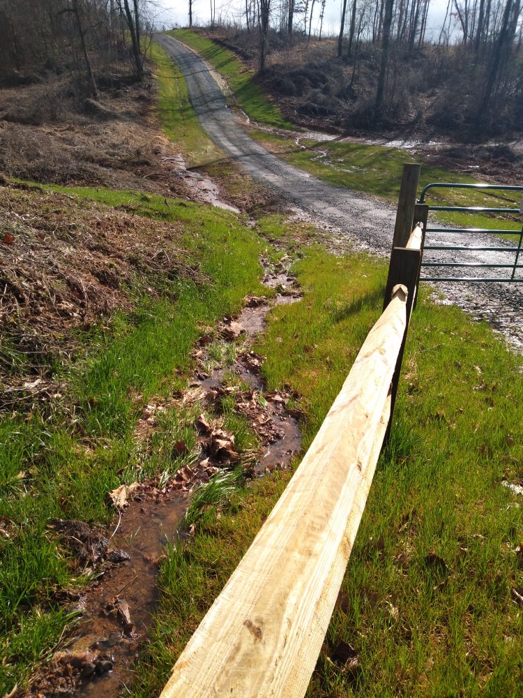

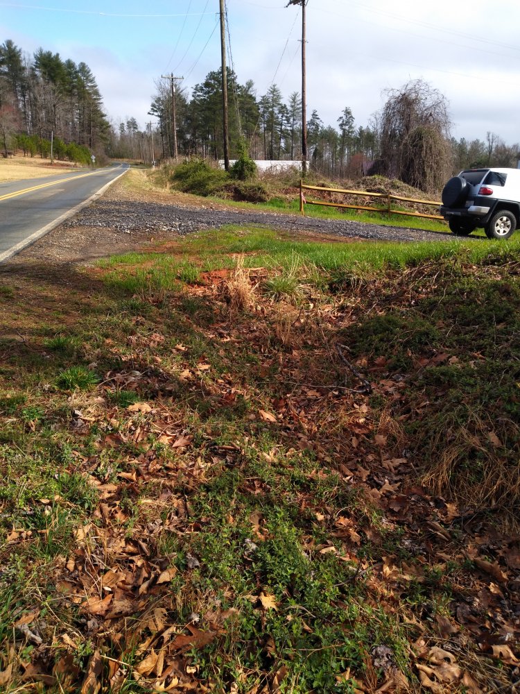

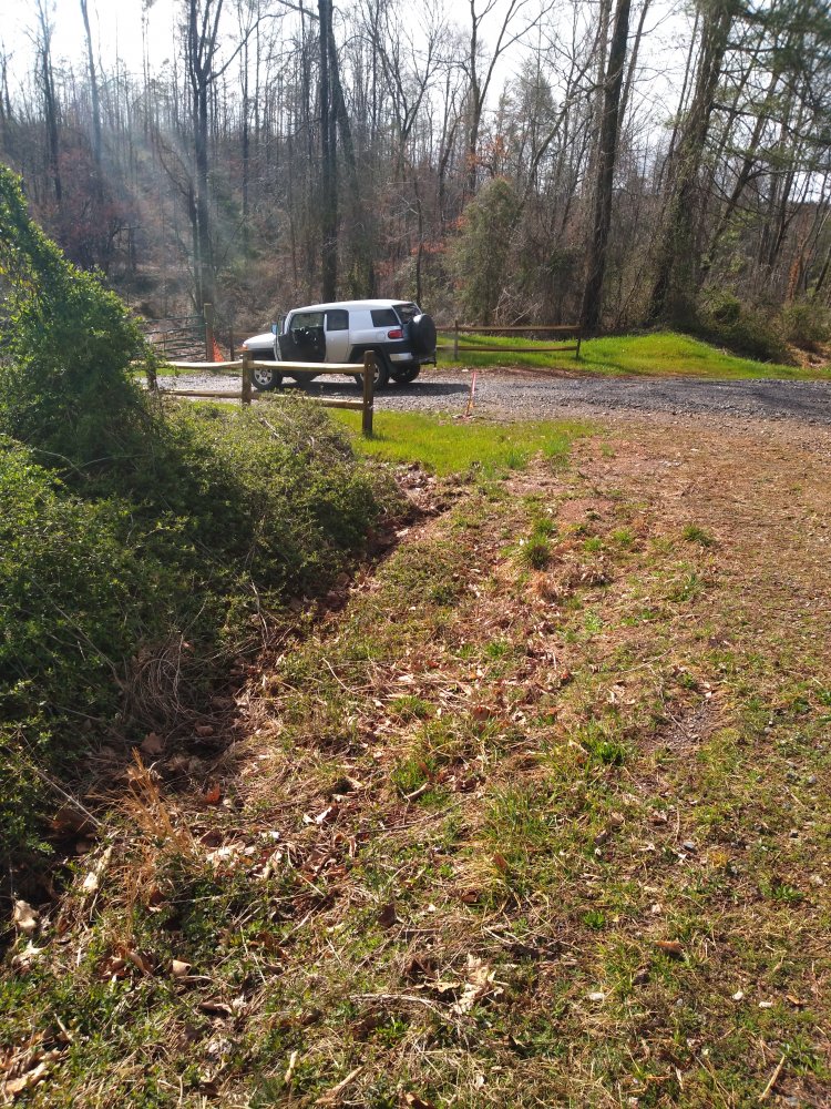

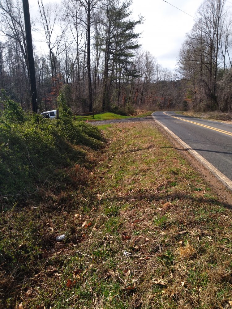

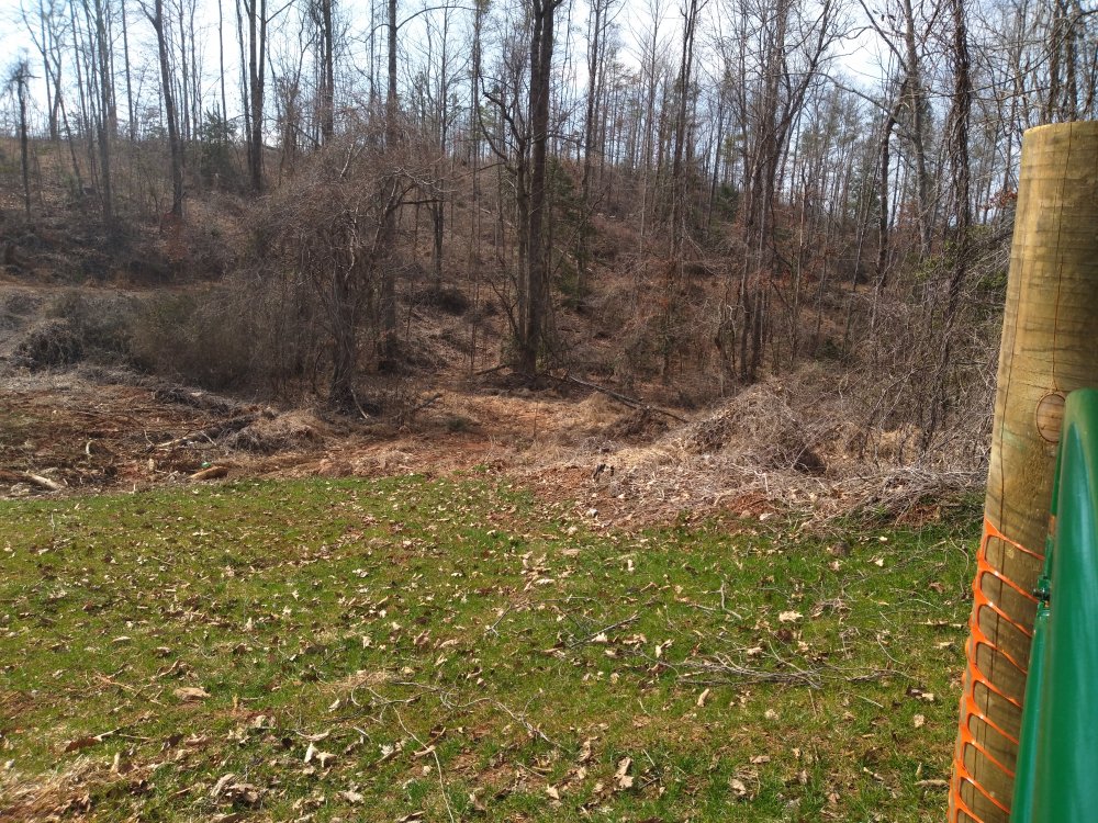

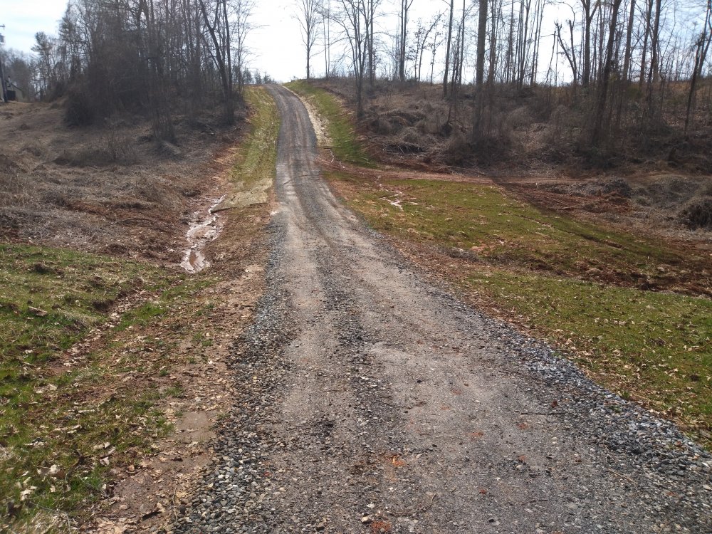

I know that every run off in burke county is orange or at least brown orange during a storm. It isn't orange water I'm mad about its the sediment and the fact that about1/2-3/4 mile of everyone's runoff is coming through my land. Here are some pics of the no road culvert situation on top of zero silt stops on the newly graded road and land.
I'll post a few pics shortly.

^^^ yeah, DOT engineer would have a field day with that. There must be a culvert pipe installed to maintain drainage. In this case, watershed is changed and introduces additional water to a conveyance not intended or used for that much water.
I’m going through this with one of my properties at the moment; constructing a drive attached to the state road and it requires a permit and built to state specs and even inspection by the DOT engineer. I have to grade the ROW but only at the direction of the engineer to improve the current drainage, can’t change direction of flow.
